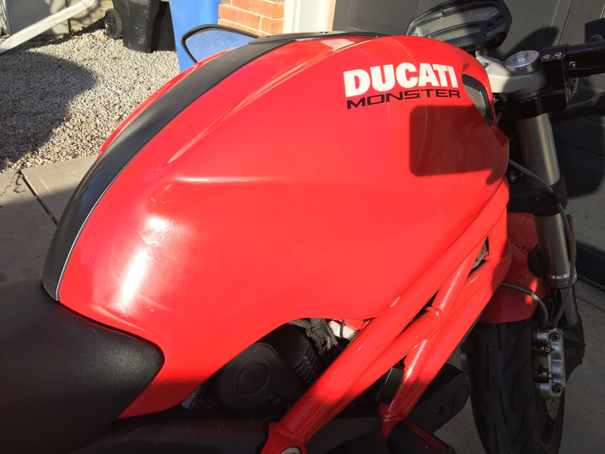

I'm with Cabaret. Just go buy the correct color-matched touchup paint from an autobody supplier. Ride the bike down, have their painter eyeball the color (or try the paint code but motorcycle paint codes usually aren't in their system) and they'll mix up an ounce or so. Should cost $20. Clean the panel, use a fine-tipped paint brush to run the paint into the scratch, let dry, and ride
Recently my brother went at his Ducati with a bottle of nail polish. The repair spiraled way out of control to the point where he's wetsanded the nailpolish, sprayed the mess with rattlecan clearcoat, sanded again, sprayed it again, spent hours trying to polish the thing, and after several days' work, it still looks like a complete turd

I've googled the textile marker suggestion from Hamblin6 and found companies that supply all kinds of very permanent markers that can be used on all sorts of materials. That sounds promising although the range of colours is of course rather limited. In another thread someone also suggested fine brushing on a colour-matched paint and then polishing it down with a fine cloth dampened with thinners before it's completely dry. Then applying a wax. That sounds promising too. I unfortunately agree with tentacleslap that the Ducati Monster really is just that! (Sorry for your brother). There's some interesting ideas coming out of this.
