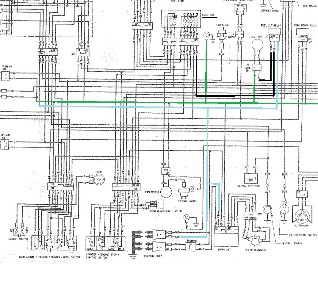

@Suuz Thanks for posting again. It certainly seems like a fuel starvation issue. When you say that Fuel is ok, what makes you think that? In looking at the wiring diagram for the 87 600, the fuel pump is wired just like the one in the F3's. Power to the fuel pump has to be supplied via the Fuel Cut Relay. That is the Black wire which I've highlighted in this wiring diagram. The Yellow Blue wire is the control signal for the Fuel Cut Relay. I highlighted it as Light Blue since I don't have multiple colored lines. When the relay turns on, the fuel pump turns on. When the relay is off, so is the pump. Well, this relay does not just get turned on (like you would think), it gets turned on and off in rapid succession. So the fuel pump receives a rapid on/off signal. You can see that the Light Blue highlight originates from the Spark Unit which is controlling the Ignition Coil for cylinder 1 and 4. The Fuel Cut Relay is located near the battery. If you unplug the connector from the Fuel Cut Relay and put a jumper across the Black and the Black/Blue wire, that will cause the Fuel Pump to run as soon as the Ignition Key is turned on (don't leave it this way, only for testing). This way you can ensure that the fuel pump is running and that you're getting fuel to the carburetors. The Fuel Pump will not continuously run. It will run until the bowls fill and the Float Valves close, stopping the flow of fuel. Once there is a build up of a little amount of fuel pressure, the pump will stop. It is a Low Volume/Low Pressure fuel pump. Since you had them recently serviced, the bowls may not be getting filled up if the pump is not working properly.
Read this over a couple of times to digest it. Let me know if you have questions and what you're able to diagnose.

So, if I understand correctly, I bypass the relais to test the fuell pump. I don't have to start the engine, I only have to turn the ignition key.
​​​​​​What am I looking for when I do that? Do I visual check for the bowls to fill?
Old Dec 10, 2021 | 07:50 AM
@Suuz I'd listen for the pump to run. It's ok to start the bike, or try to start the bike. The link in my signature was done quite a few years ago (ok, I just checked and it's been 12 years), but there is a video in there that will give you an idea of how the pump sounds when it's running. The contacts in the pump burn up after a few years and need to be replaced. I'm not saying that is your issue, but it's possible. In the video, the pump is not connected to the fuel lines and that is why it will keep running. If fuel was in the lines, pressure would build up and it would stop. The pump from the 1987 has a different part number, but wouldn't be surprised if it was the same, but with different connector. How they function is the same though. You can put your hand on the pump and feel it run. The goal is to make sure you're getting fuel into the bowls of the carburetor. You can loosen the drain screw on the bottom of the float bowl and verify that gasoline is in them. I'd put a good size rag under them when you do check as it's going to dump gasoline on your engine.
