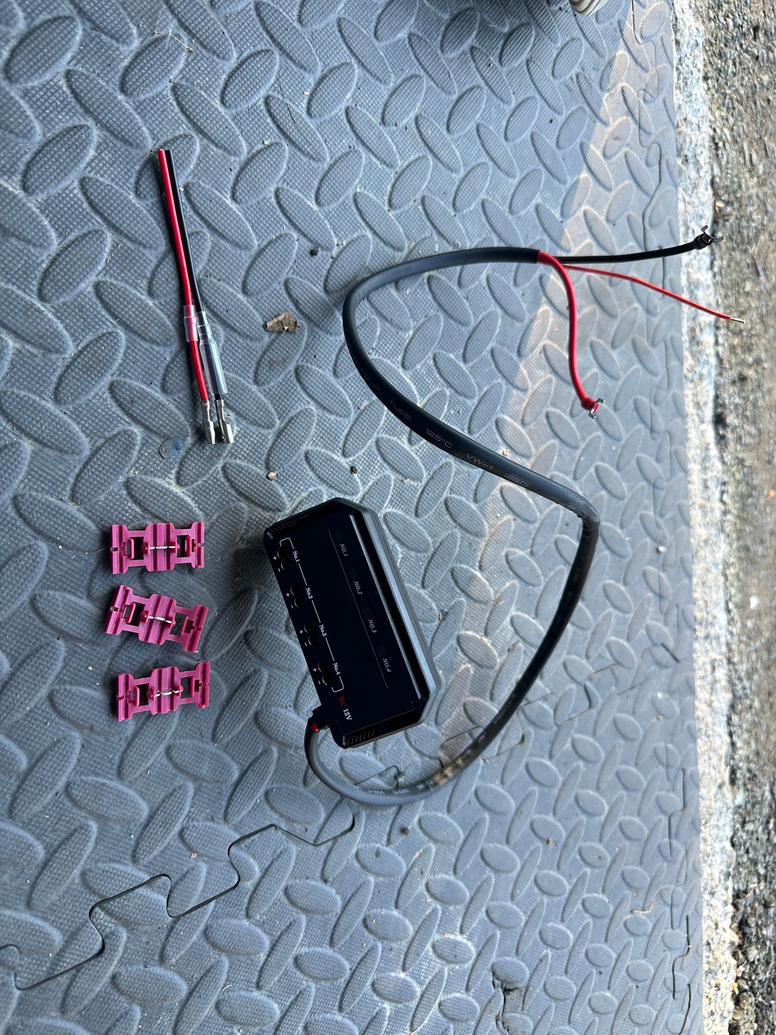

Sadly no instructions. It’s clear which cables go to the battery and which is the ACC, just unsure where to locate the best cable on the bike to attach the ACC cable. Also unsure what the additional black and red cable is for or if it’s needed.
See photo of of parts supplied.

Extra wires not needed.
Connect small red activation cable to ignition-switch red/blk cable. Look for it entering fuse-box. Measure it there to be sure it’s only ON when key is ON.
