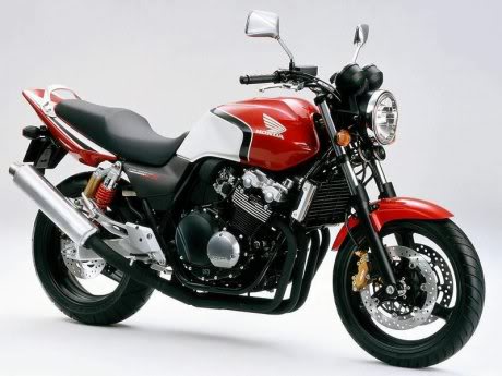

Funny how just after you posted about getting it, I was taking the dog for a walk & round the corner someone had parked on of these.
To me they look great, they also come with ABS & Stainless Steel exhaust & here they are sold as a LAMS bike (Learner approved motorcycle scheme).
If only the made one around the 650/750 range.
