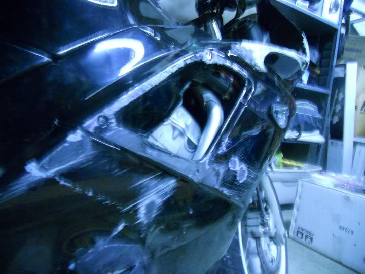

Me and my 94 f2 went down last night
<a href="Pictures by JensonDaggett - Photobucket" target="_blank"><img src="http://i614.photobucket.com/albums/t...ggett/blah.jpg" border="0" alt="Photobucket"></a>
I'm ok, little road rash
Besides fairing damage, the metal piece on the end of the right handlebar was bent and the throttle sticks a little bit now. I was wondering what would have to be done to fix that? I'm debating whether i should sell it or fix it. I'm very financially limited so i'm sort of hinting towards selling it but I really want to keep riding. My question is how much are fairings, how much for a respray, and what needs to be replaced for the throttle sticking and how much? also how much could i get for the bike? It has 23k miles, a Yoshimura exhaust, still runs like a champ besides the throttle sticking a little

well you can get new plastics for the whole bike on ebay for anywhere from a few hundred and up usually but can run into some fitment problems with those cheaper ones just have to play with em or modify a little for fitment. gettin it resprayed at any shop can be done as long as the fairing isnt cracked just have to get them the color code then it would be without graphics which you can get and replace also, have to search around your local shops for the best price prob be damn near the same as buying new plastics from ebay. as for the throttle the slide underneith the grip may have gotten cracked its just plasitic its what lets the throttle twist on the handle, have to check the throttle lines first make sure one didnt get bound up somewhere somehow from it goin down, might have even just shoved the grip further up the handle and the rubber is just hitting starter switch housing which is cuasing it to stick a little, just have to take a good look at everything and diagnose and if you cant figure it out might be worth cutting your grip off to check the slide can always get new grips they are cheap, and if the plastics are just scraped up and the throttle is an easy fix just ride it like that till you can fix it, ive done it and im sure lots of other guys have done it. and the bar end that is messed up might be a pain to get out cause its bent but its just a screw that goes through it into an expander that keeps in the bar, cut it, use an easy out, or maybe you'll be lucky and it will still unscrew with the bent bolt just have to try. and your bike is retail valued at around 1800-1900 thats what a dealership would ask for it, so with the damage you might be looking at like a grand or a little more you would get for it selling it private party (just my opinion). also look at this thread from this forum about painting it yourself without a booth or spray guns and not have it look like a walmart rattle can job if you wanted to have a fun project and tear down the bike and learn some crap lol click below

Thanks man! I was able to unscrew the handlebar piece and i hit the inside of the throttle with some lithium grease and its not sticking anymore i think I'll ride it like it is until i can afford to get new fairings. I'll check out your rattle can link too, couldnt hurt if im getting new fairings anyways haha. Thanks for the help
