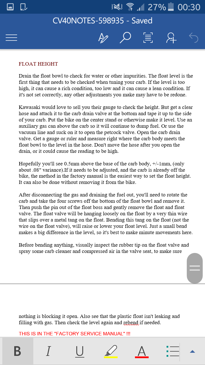

No probs mate .before u split the carbs take some photo's of area's u think u will get stuck on...Read the pics iv uploaded .I know the cvk40 carbs are not for the cbr I think it's Harley .. buell but it gives details on how constant vacuum carbs work

Just a quick update to say that my bike is (by magic) running properly again. Due to work commitments and bad weather I wasn't able to work on her until today, alltho' I didn't actually do any work. Before commencing carb cleaning I thought I may as well take her for a ride to see if I could blast the clog clear, I've tried this a few times already and it hadn't work so far. Just as I was coming back the clog finally cleared up, then about 30 seconds later I ran out of petrol and so I'm wondering... coincidence or did the lack of fuel in the clogged jet help force the clog out? I might give it a clean anyway since I've got some carb cleaner and a ton of info from guides that I'm only going to forget otherwise.
Anyway, thanks to Cabaret, Frank and Daniel for chipping in (especially with the pics)... it's much appreciated
