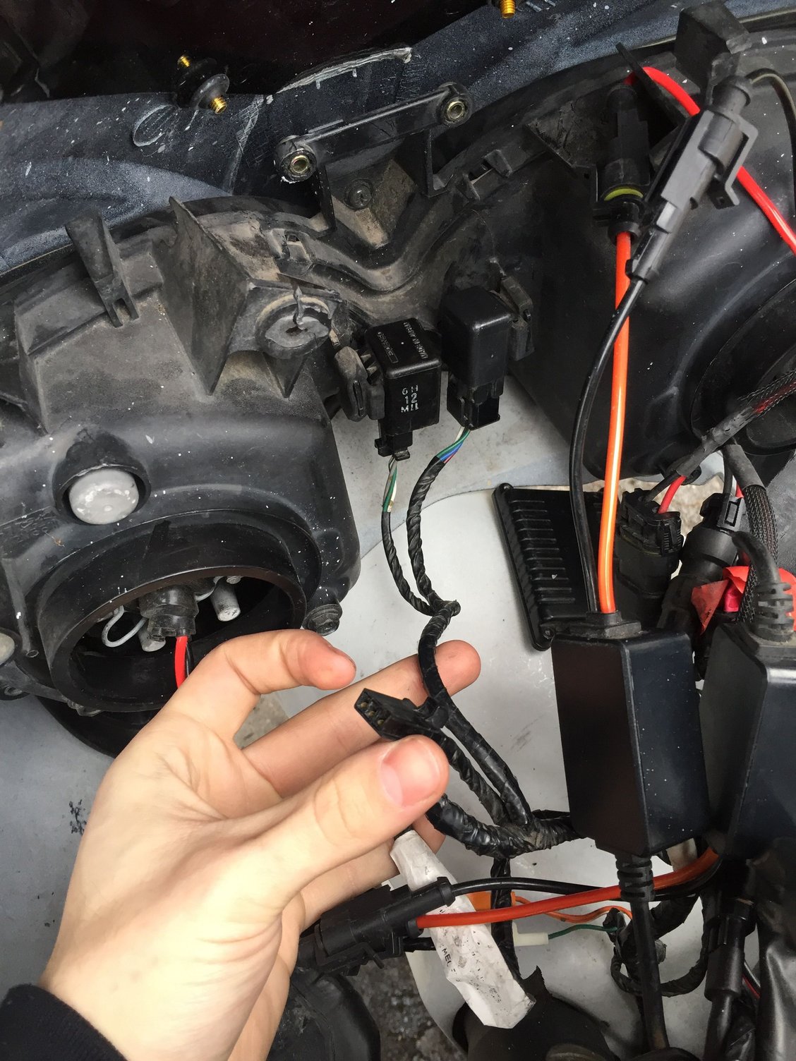

I changed my blinkers to flush mounts and ever since, my fuel pump wont prime and my bike will turn over and over and over. I have a empty connector and wondering if that’s the issue. Cant see anywhere that plug would go? Bike turned over just fine before all of this. And yes my headlights work

Hi the only 3 pin plug I know at the front end belongs to the BAS, if thats disconnected your bike wont start

it does have the two little relays on the front that bolt to the back of the headlight housing, and one of them has that same exact connection. But I don’t know where it would go I don’t see any female connectors.

my bike doesnt even have a BAS on it :/, it was probably bypassed by the last owner

Then you need to make sure it's still bypassed.

As Demon say's bypass the switch, there are 3 wires , Green , White and Red/White, connect the Green and the Red/White with a piece of jumper wire , on the harness side and your bypassed
so I connect the two outside wires on the 3 pin plug together?

Thats right, 2 outside wires

so just to be clear, all i’m doing is splicing those two wires together
