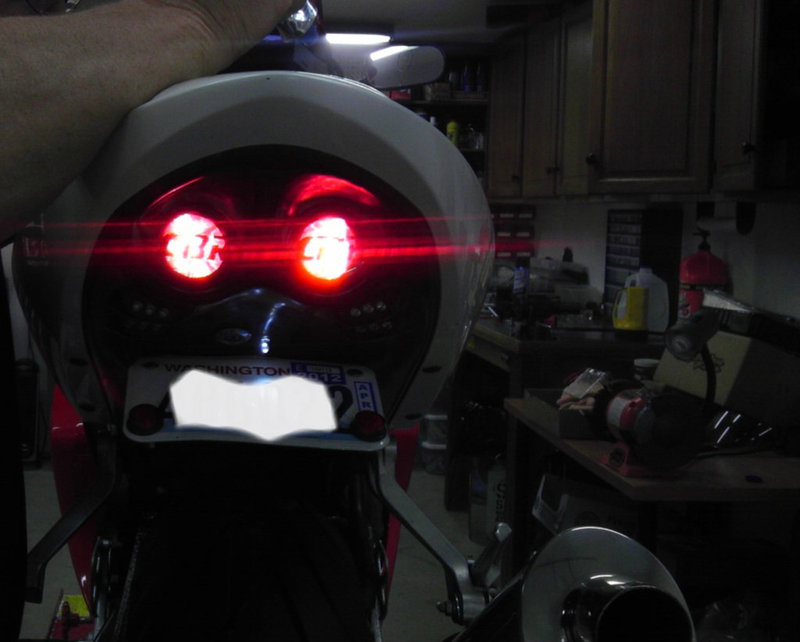

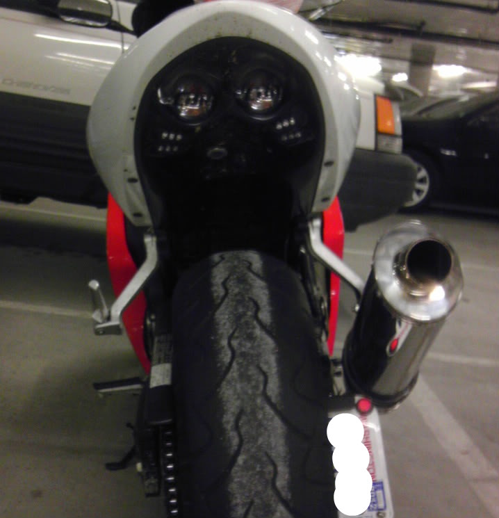

I bought a license plate light with a bracket but it was crap for the money. Plus I didn't like the swing-arm license plate holder, it's illegal and ghetto.
So I just drilled a few holes in the undertail after lining everything up. I used the plate light bracket just to mount the license plate. Lock nuts and/or double nuts are a good idea. Then I wired the LED through the undertail. I like how it turned out... Pretty clean.
You could do the same and save more money than me, just buy a regular wired LED and some L-brackets from the hardware store. You'll also need long screws and nuts for the bracket. The LED is hot glued and also helps you find the keyhole in the dark.
After:
Before:

Hurricane_rider- that looks good, I did the same thing when I made my undertail. Name:  tn-2.jpg
