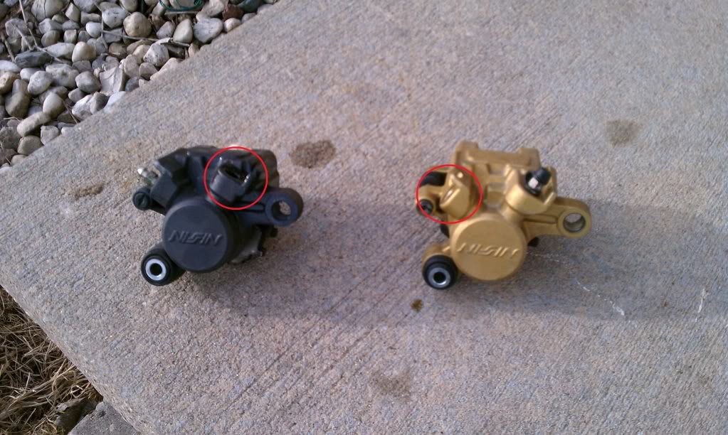

Originally Posted by sjsharks33
really liking the gold calipers! So if I get calipers off a 929 or a 954 will this work with my stock brake lines and stock pads?
The fronts will work, but on the rear the brake bleeder and line mount are flip flopped so I don't believe the stock line is long enough.

thanks for the pic! so did u order your rear brake line a little longer? I already order the rear brake off ebay for 19 bucks shipped. I'll wait to find a sweet deal for the front calipers.

i wonder if you can just swap the 929 bleeder valve from the front to the back like on the f4i

Yeah I ordered both my fronts and rears a little longer. extra 2" up front and 4" on the rear. Did it just so I knew I'd had a little wiggle room when intalling them. Turned out to be a good thing on the rear, cuz I was unaware that the bleeder was switched around.
Nope the hole for the line is bigger than the hole for the bleeder.
