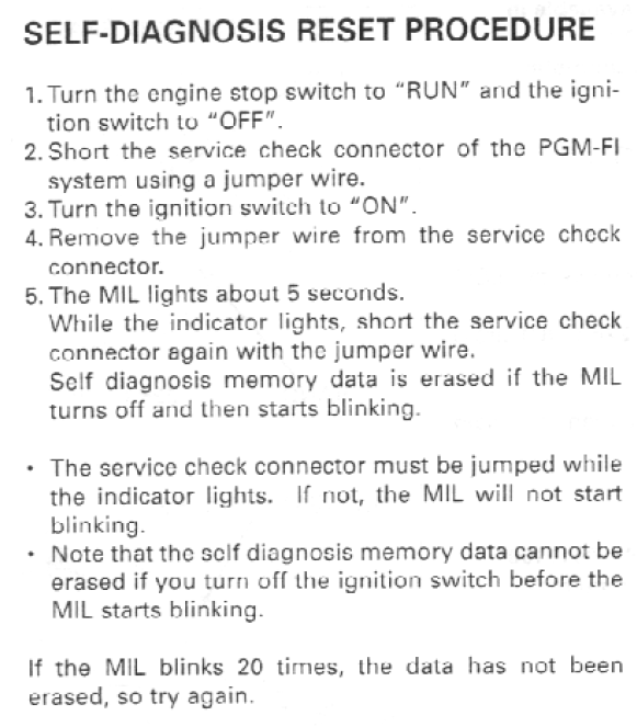

Will the stored codes clear out if I hold the battery cables together for awhile like you can do in a car?
Old Oct 20, 2021 | 10:00 AM
Follow this process.
Old Oct 20, 2021 | 10:58 AM
FrankenRZR's Avatar
Joined: Oct 2021
Posts: 4
Unfortunately I can't. I have the key switch eliminator. I would have to cut my harness up.
