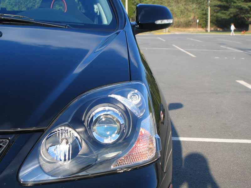

And the current lights on my civic, which are an Imported HID Projector:

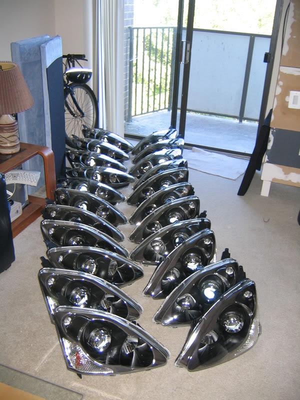

And my booty stash from one batch I imported
