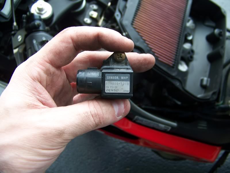

hello again chestnut. did you find your map sensor yet?

25MPG sounds more like a FPR issue than a MAP issue. You should be getting between 35 and 50. That goes for everyone (except you track peoples)

If you let it sit for a few days does the motor lock up when you try to crank it? Remove the oil filler cap and smell it...does it smell like gas? With out taking it apart....all this leaning towards fuel pressure regulator. To be sure, pull the vaccuum line from the FPR and see if it is wet (with gas). If it is wet, the regulators diaphram is ruptured. None of the dealers or shops around here stock this item, so i had to order it. 4-7 days till they ship, then 3-5 till i see it. Mean time, my bike is sitting in the garage stripped down and drained, while i wait for the FPR to arrive at my door.
My FPR was leaking bad enough that i was getting 26 mpg with all the sputtering and smoking, and if i let the bike sit for 12 hours or so it would hydrolock the engine, hence the crankcase being full of gas. When i drained the oil, I got 1.5 gallons out of the oil pan....
