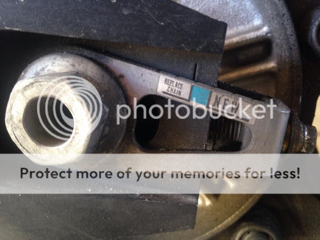

Ok so from what your saying sprock, I won't need to replace my chain if I just go back to the stock 16T up front. Right now the chain is reading in between the replace chain and the new chain marks. But then again it is also quite loose right now and I need to tighten it since the previous owner didn't know how to do any of this.

Bigger sprocket will use more chain, you'll be fine.

Just got my chain tightened and it now shows just over the replace chain line. With the extra tooth it should send it in the right direction.

Before saying whether or not to replace your sprockets and chain, I'd have to see what the sprockets look like. The front sprocket is 16T stock and the rear is 46. If you have steel sprockets and they're worn, they will cause the chain to wear RAPIDLY. Aluminum sprockets will absorb the majority of the wear in the system, but need frequent replacement. IF your sprockets are steel and in good condition I would leave them alone. Put the 16T on the front. From what you're saying, you'll be much happier with that setup. As for the chain, I would replace it. The bigger sprocket up front will put the chain somewhere back into the "serviceable" range, but not by much. I would definitely not trust any previous owner to have maintained such a delicate and essential yet easily overlooked component. I lost a chain on my first bike and I've never let it happen since, but I've been out with guys who lost theirs. The best case scenario - it will ruin your ride and leave you stranded. Moving up the disaster scale from there, a chain whipping around can cause SUBSTANTIAL and CATASTROPHIC damage to your motorcycle (mine sucked up into the engine and blew out the water pump). And, finally, the worst case scenario - the chain hits your leg causing SERIOUS injury and most likely a crash, or causes the rear wheel to lock up, most likely causing a crash and SERIOUS injury. If you're still not convinced, a decent way to quickly check your chain is to get down on the ground behind the bike and try to move the lower free portion of the chain (between the two sprockets) from side to side. There should be almost no deflection side-to-side. A better way to check the chain is to get the rear wheel off the ground, adjust the chain so there's about an inch of free play at the mid point between the two sprockets, and then slowly turn the rear wheel, checking to make sure that the free play stays the same no matter what position the chain is in.
