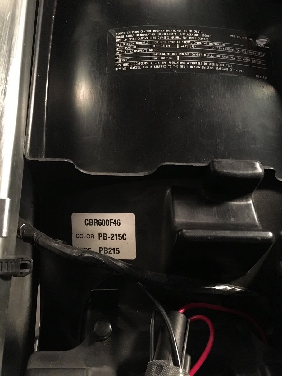

I'm fairly new to the CBR scene as well and have an '06 F4i. This is the only "on bike" designation I could find...
Not sure what the "6" is for at the end; maybe for 600cc?

Hey,
Thank you for the reply Doc Samson, I did saw that label on mine I was doubtful as it mentioned Color and all, I though it was related to the plastic part it self.
But if you believe is right then mine should be CBR600FS1 (what ever 1 means)
So lest see if I can search part for it with more ease
