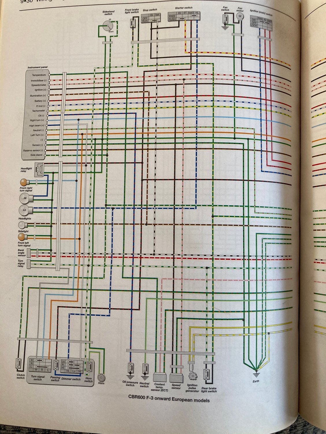

Hi everyone, Im currently dealing with the fuel pump not priming but I'd like a wiring diagram for my diagnostics BUT it's a uk spec bike with the hiss system.
there isn't a pink wire on mine or zener diode.
the headlight works so not the green Earth wire in the grey plug,
the kill switch works ok,
both relays are ok.
fpr is ok.
someone has took a power from the ignition red wire direct to the fuel pump but it now runs continuously.
thanks, Pete.
Old Apr 13, 2021 | 05:39 AM
Adcol's Avatar
Joined: Mar 2021
Posts: 23
Hope this might help?

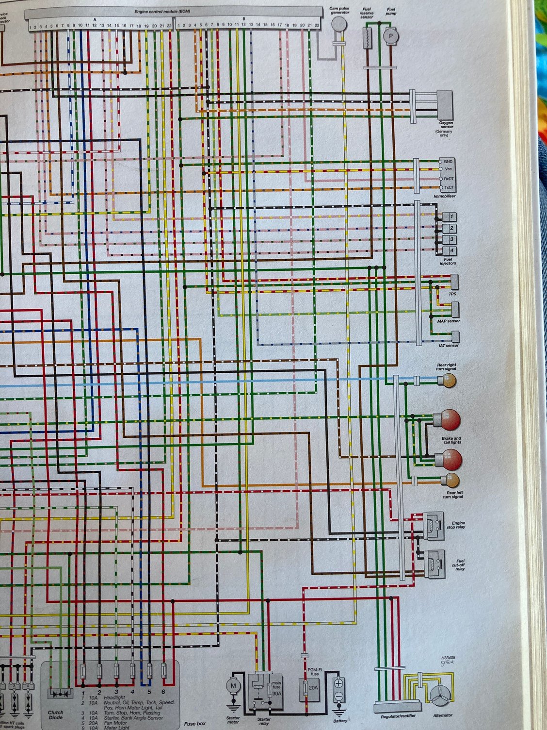

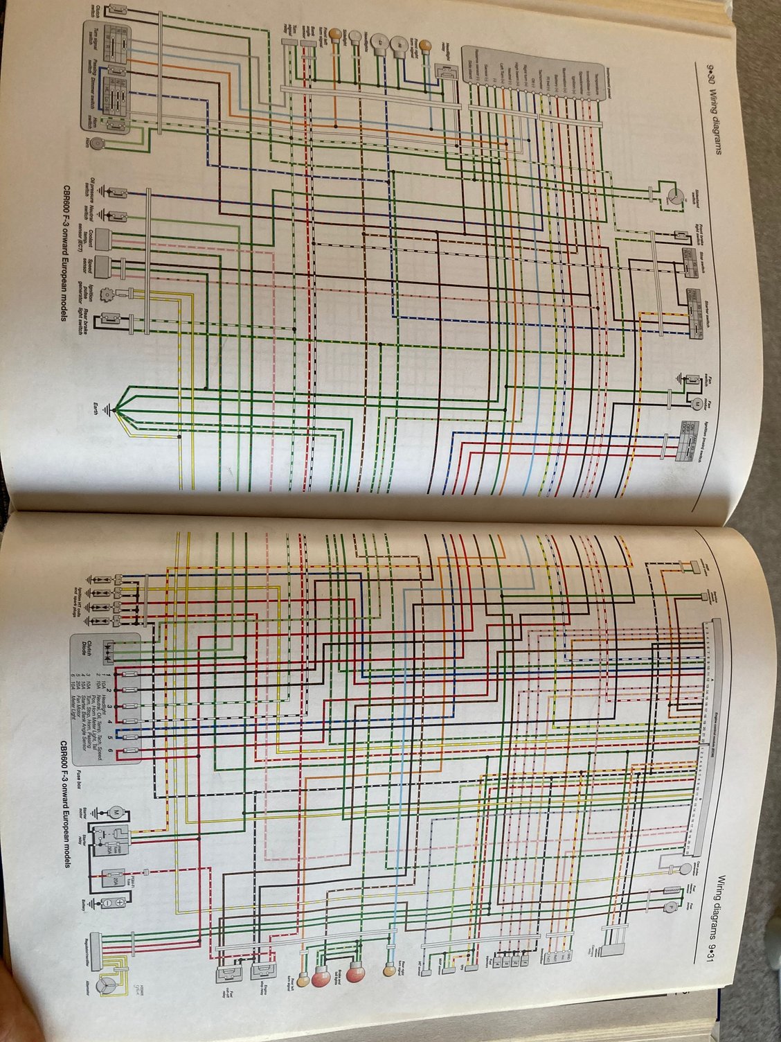

That's great, I don't suppose you've got the other half of the diagram have you ? Cheers

Sorry I thought I’d uploaded them all, here you go.

@Adcol Nice wiring diagram. That's the first I've seen in color like that. Who's documentation is that? Honda factory, or aftermarket manual like Chilton's or another?
