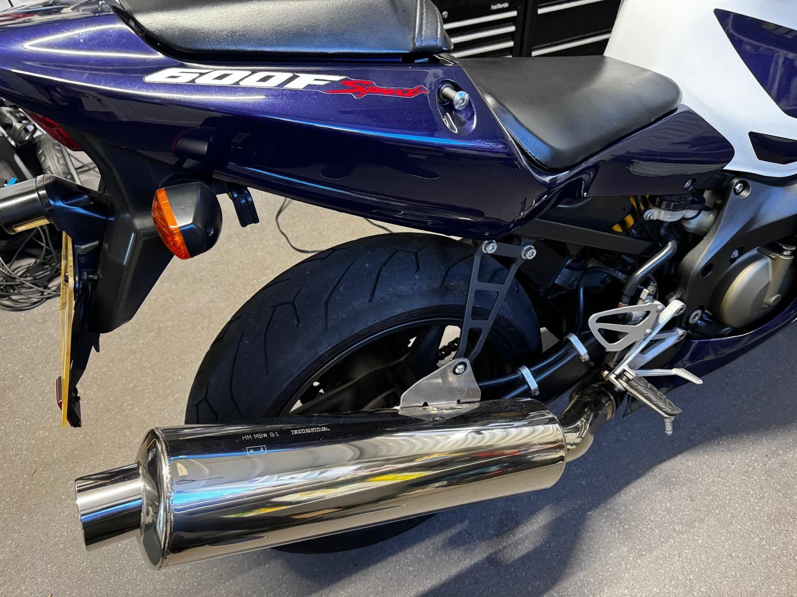

Hi All,
Just letting you guys know that a Fireblade 900RR exhaust hanger bracket will fit an F4i.
I had trouble sourcing a hanger for the F4i, so figured the other models shouldn't use a vastly different bracket, so took a chance on the 900RR (SC33 919cc fox eye model) one which looked like the closest match. Other models may work also.
Bought a cheap one from AliExpress and it fits perfect.
Leaving this info and photos here for those that need it in future
Cheers
