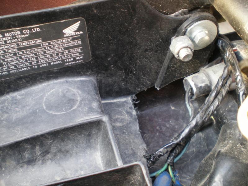

I have that one on my 01 and i never took the whole battery box out. i just cut it back enough to get the end of the undertail to tuck under like its supposed to. i can take some measurements when i get home and maybe a pic or two to help you guys out!

basically you just need to cut about a half inch from the tool holder but make sure you cut back to where the stock undertail bolts on, it will basically look like tabs you should be able to just take the bolts out and pull the stock one down a bit and just cut the flap off and around the bolts. i attached two pics so hopefully they uploaded! good luck
Attached Thumbnails  01 F4i undertail Install Help!!-p6060671.jpg    01 F4i undertail Install Help!!-p6060670.jpg
