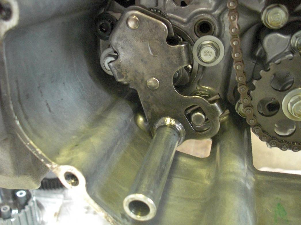

My guess is that you have bent the shift shaft just a bit. Then as the bike warms up it binds up a bit.
If the gear shifter doesn't return all the way to the middle position, then it can't grab the next gear to shift.
This is why if you stop and fiddle with it, it's starts working again, you're manually pulling it back up.
I'd first visually check the shift linkage/lever etc.
Then put the bike up on a rear stand and turn the rear wheel by hand and try shifting through the gears manually.
If that shows nothing, then pull the clutch out and check it.

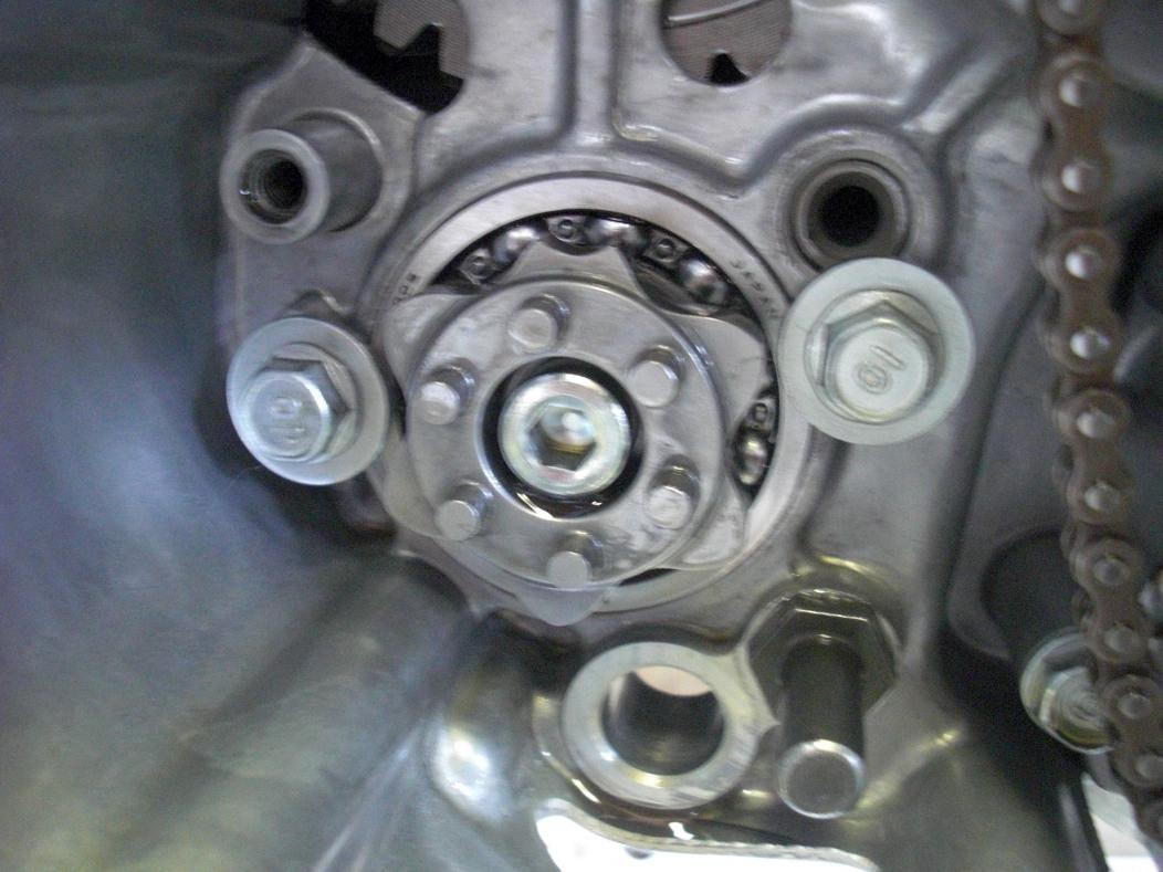

Finally I'd probably look at the shift star/detent/springs and those grabby claw things (can't remember their name right now, see pic)
and make sure they are working correctly.
Then clean everything and reinstall and see if the problem persists.

Also i noticed in that pic there's a hole at the end of that shifter thingy, mine is just flat. Probably no big deal i just thought it odd.

Take the clutch cover off and try to watch the shift star/ratchet thing behind the clutch and manually run through the gears again.

Took clutch cover off to watch grabby things lol always returned to middle nothing I could see looked bent.
