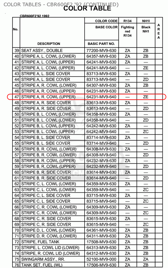

I found an right upper fearing decal on ebay. The part no is 64231-MV9-630ZA. I asked the seller if he could tell me what color this decal is. He cannot tell me because he cannot see through package and I presume he does not want to open package. I am trying to figure out how many different colorways my bike was manufactured in? 1992 CBR 600 f2. I have the purple pink and black, white rums model. What other colors was my bike made in?

There were 2 color schemes in 92. Black/Blue/Pink & Red/White.
Below is the color table for the decals. 64231-MV9-630ZA is for the red/white scheme.
The one you need is 64231-MV9-640ZE, it's for the black/blue/pink scheme.

Thank you so much! What I am looking for is the left side...so is it the 64241-MV9-640ZE? And I didn't know this color was considering blue...it looks purple!
thank you very much for providing this table for me!

Yes, that's the part number for the left side.
I think Honda officially called it blue and brand new it probably looked more blue.
It probably looks more blue/purple now because it has faded over the years.
If you google some images, you see some that look blue, some look purple, but they are the same scheme.
