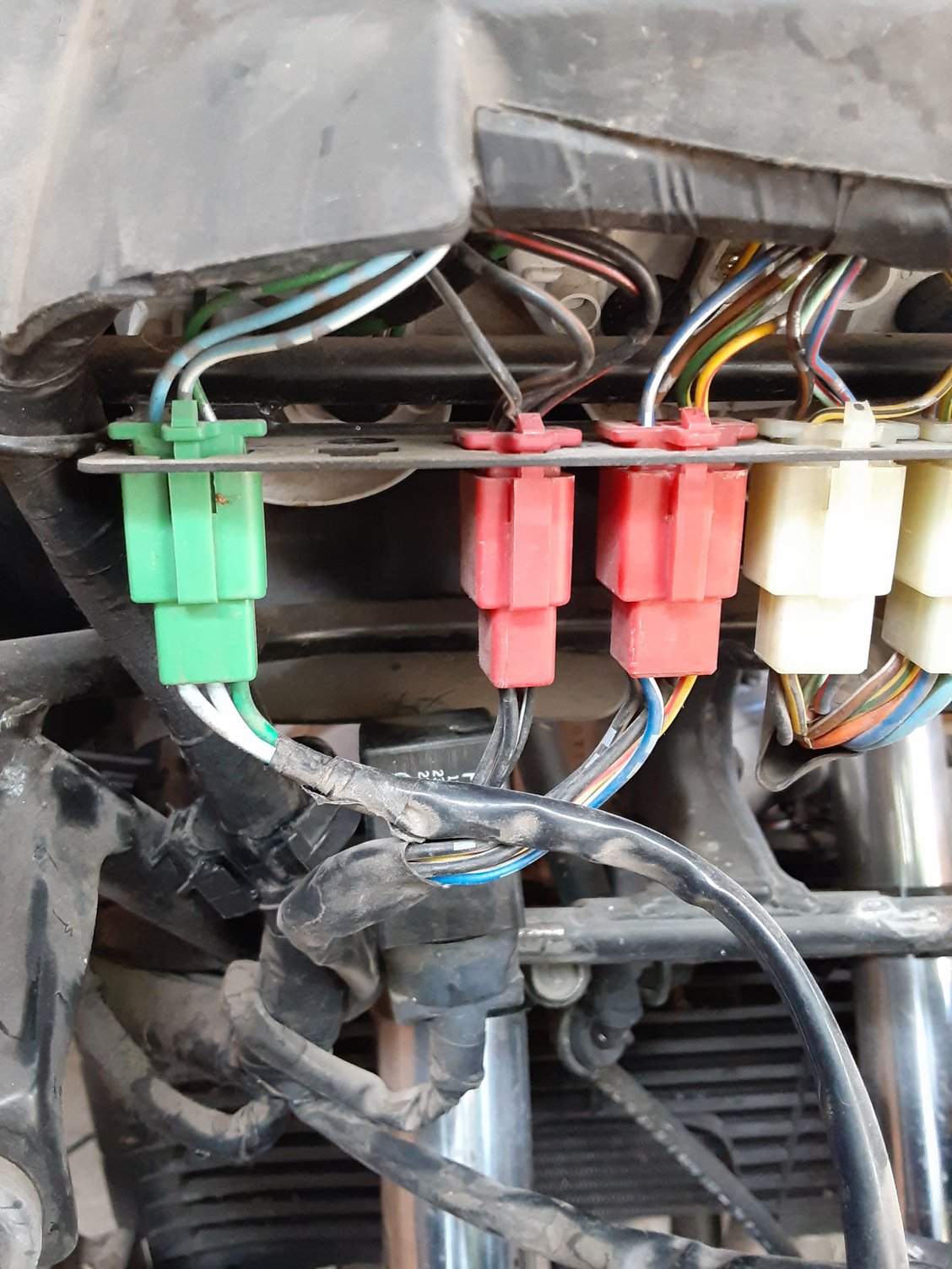

great! Thank you. Got it. Now onto the red clips...how to get those unclipped. The little tabs are super small. Do I needle nose them as well?
Old May 30, 2020 | 02:43 PM
Phil314's Avatar
Joined: Sep 2008
Posts: 674
Likes: 53
From: 45.2521, -93.5612
Those you should be able to squeeze the tab just below the metal plate with one hand.
Then wiggle the connector side to side while pulling down.
Sometimes it helps to hold the top part in place with your other hand.
Then push up first, this helps the tab unlock, then pull down and wiggle.
You might also be able to push on the top part of the tab with your finger to get it to release.
These usually aren't too hard to get apart, trick is to get the tab to unlock first, then pull.
As long as you have those connectors apart, I'd put some dielectric grease in them.
Prevents corrosion and they'll come apart easier next time too.
Old May 31, 2020 | 08:36 PM
CeCeF2's Avatar
Joined: May 2020
Posts: 48
From: Sedona
Default got it the starter switch changed and working!
Update: got the red electric clips loose. completely bypassed the whole clipon removal process. removed the gas tank instead and air cleaner, and loosened the throttle cable bolts to get the needed slack on the cables. Once I got the needed slack everything was zip bam boom. done. Thank you for your support with my project. Now onto the next...
