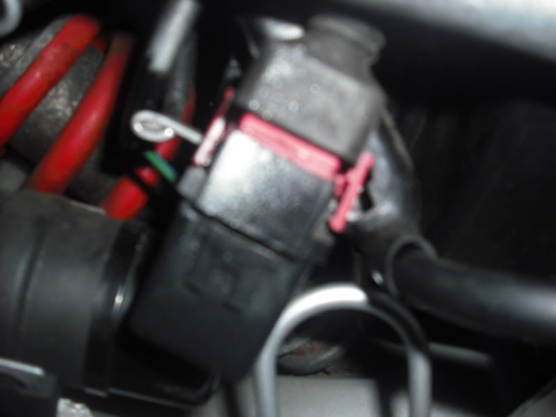

Anyways, provided we've got the same idea of nothing (nothing = literally no things happening) what I would do post all the work you've done is see about bypassing the starter solenoid:
That's what it looks like
That's where it's located.
See the top two terminals? With the battery still connected jumper those. The standard method is to put a screw driver accross the starter solenoid, however it may not be an option as there is that darn pesky plastic tab in the way on that solenoid (holy lameness batman!). Be creative on a jumper that is SAFE to touch since that is straight off the battery and will give you the full jolt of the bike battery!
Anyways, once jumpered, that SHOULD cause the bike to try and turn over. If your bike starts by doing this, your starter solenoid is bad. If it does not, SOMETHING in the safety setup is killing the starter and the spark. This is designed so the bike won't start with the kickstand down, in first with the clutch out, etc etc. Doing this test should help shed some light on the issue.
