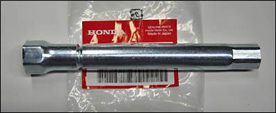

I don't think you have to remove all that stuff to get the plugs. Next time, spend the $10 on the honda plug removal tool.
One of these jiggers:
Its just the rubber boot to hold the plug for easy removal and replacing.
