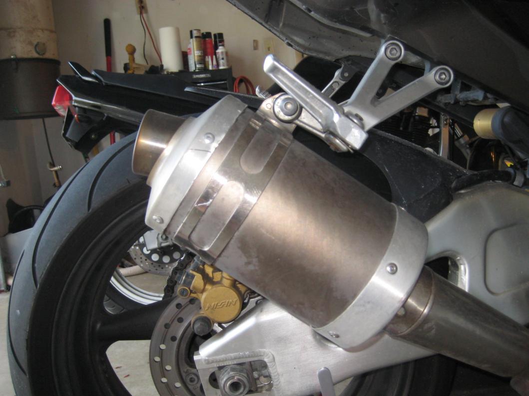

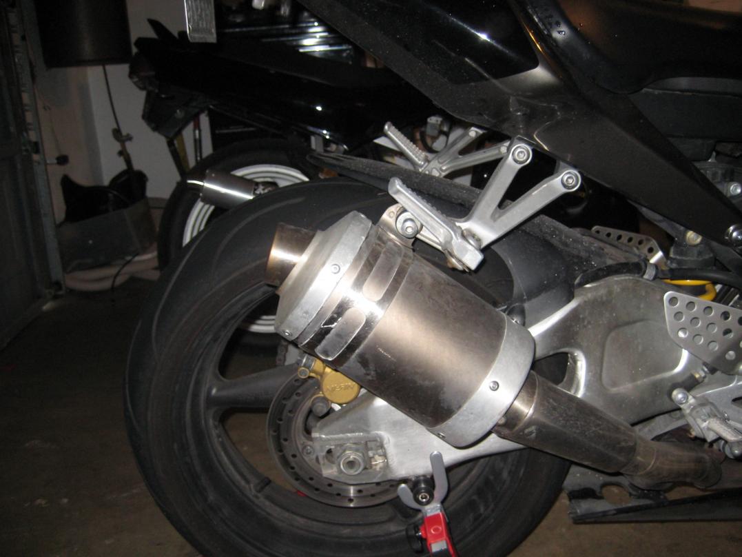

i cut mine down, just above the mounting bracket. however, i put mine almost all back together (minus the stuffing). it sounds great. i cut it just a few inches at first, then a little more, and a little more after that, until i got down almost to the bracket.
if you put the inside back plate back on, it will make it sound much quieter. thats what these pictures show (even though its much shorter than yours). for example: at bike nights, i cant hear my bike over all of the harleys and ive had toll attendants say things like "wow, finally a bike thats quiet" (which was after a group of harleys and sportbikes). the inside back plate also keeps a lot of the backpressure, so you won't lose a lot (if any) power. mine has absolutely NO baffle in it. there is a hint of "rasp" sound from 7k to 7.5k, but aside from that, it sounds perfect like any other aftermarket exhaust. also, the inside backplate wont let as much moisture in (in case it's raining).

No power loss on mine. I like it now. Sound, looks, it's sweet. Still a little loud though.
I will try to put the inside plate on like Conrice says.
Conrice<-- How did you separate the plate from the muffler housing you cut off?

it is its own seperate piece. so twist and pull (push from the other side) and it should come out. once that's done, you'll see the rivet holes, just line everything back up and you're ready to re-rivet the exhaust back together.
