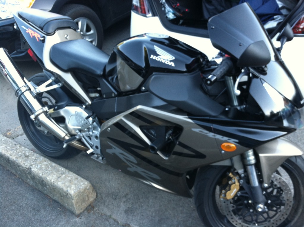

I've got a fuel tank with a few imperfections and a few small dents
I was going to swap out the fairings but the tank is black with titanium accent. I cant seem to find the farings that match.
So now i thought - change the tank but an OEM fuel tank is alotta money - I thought i saw someone with a 600rr fuel tank on their 954rr
is this possible to do?

yeah i kind of assumed that - so i guess i'd have to replace the entire thing. it sucks cause there so much
heres a question thats been driving me nuts
the tank u have for the 954rr in the picture is titanium on black. mine is black on titanium....
i cant find that pattern ANYWHERE!

I have a feeling i'm not going to like the outcome of this - but i bought it with 3700 miles on it - and i cant find anything that looks like it below.
Other then scuffs on the body here and there - under it the engine, pipes and everything else looked super clean - i just hope i didnt get scammed

hmmm.... looks like someone just flipped a bunch of the colors on the titanium scheme. the tail is a titanium, the side fairings and nose are flipped on the colors they're supposed to be. where yours is black - it should be titanium, and where it's titanium, it should be black.
it's custom, but it doesn't mean its bad, i like it. so ya, that's not an oem scheme. you'd have to find a black tank, then get those decals (and a bunch of sites make every color combo - so it'd be easy).

yeah i had a feeling about the swapped colors - makes me worry about the odometer being legit then though
i'd really like to get new fairings but i dont know what to do with the tank is my problem.
Any suggestions where i can/should order from?

don't worry about it if the bike runs good. the bike could have gone down, but if you're taking care of it, i wouldn't worry about it. the miles really aren't an issue so long as you take care of it. change the oil and ride it.
if you buy a titanium tank, it shouldn't look *too* out of place on there.
i buy everthing via ebay and craigslist. if you're going to get different fairings, stay away from the china fairings. stick with oem. it'll take longer to piece them all together, but it's worth it.

but i have to be honest. i dig that paint scheme. id leave it at that. it looks good and if a "fiddyfour-er" sees it, it'll make them look twice. it did me anyways
