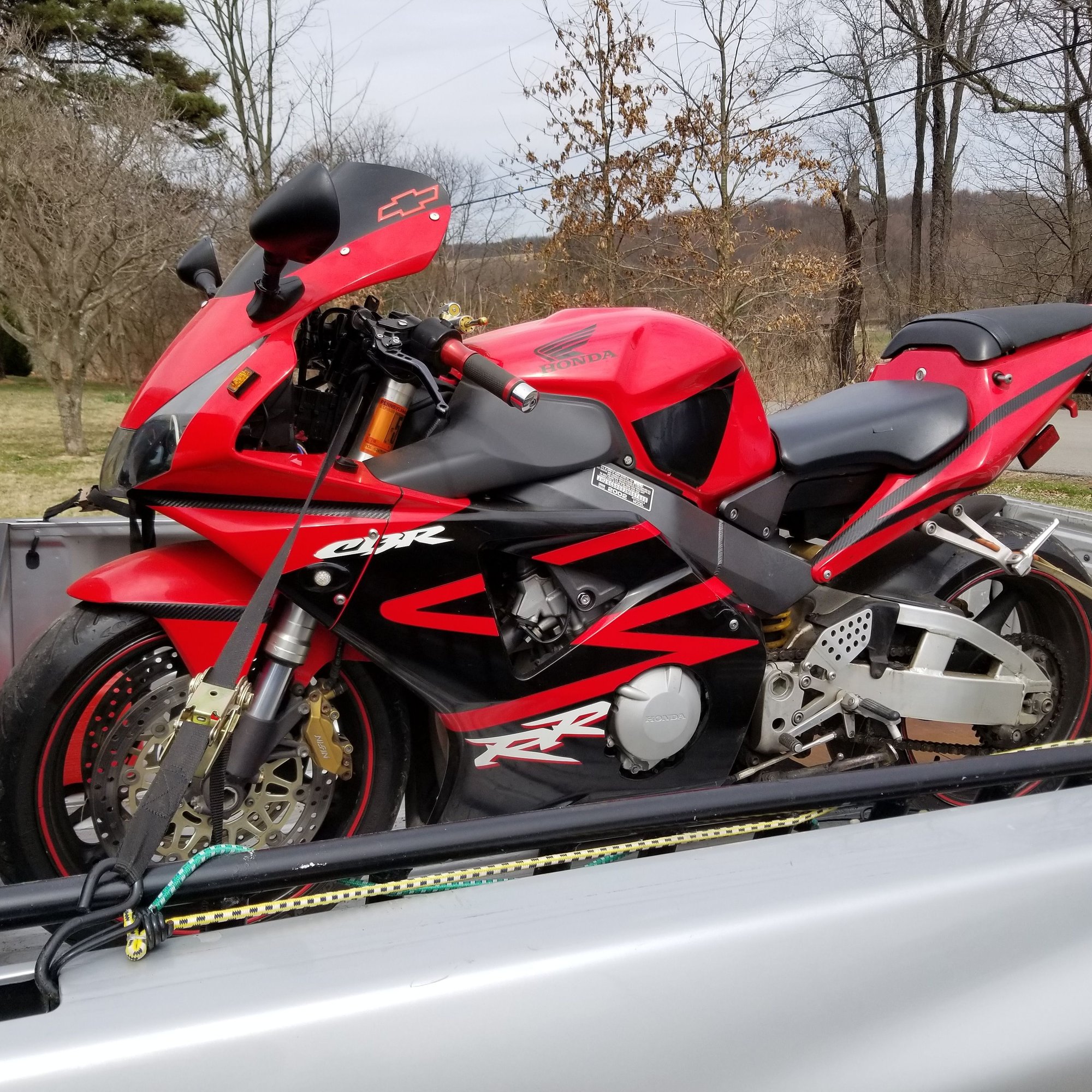

Hey guys, picked up an 02 cbr954rr. Replaced charging system, ie battery, rectifier, and stator after it died on me. Now it will not crank over, it just clicks from the starter solenoid/relay. My thoughts are..is it possible to misinstall the stator to freeze up the starter? I hooked 12v to the starter and it sounds like the apendature is moving in there. There is some buildup inside the starter solenoid but nothing that I think would fault it. Another thing is when I go to crank it over my battery voltage drops to 5v or so, which is crazy low. All fuses good. Any advice helps
