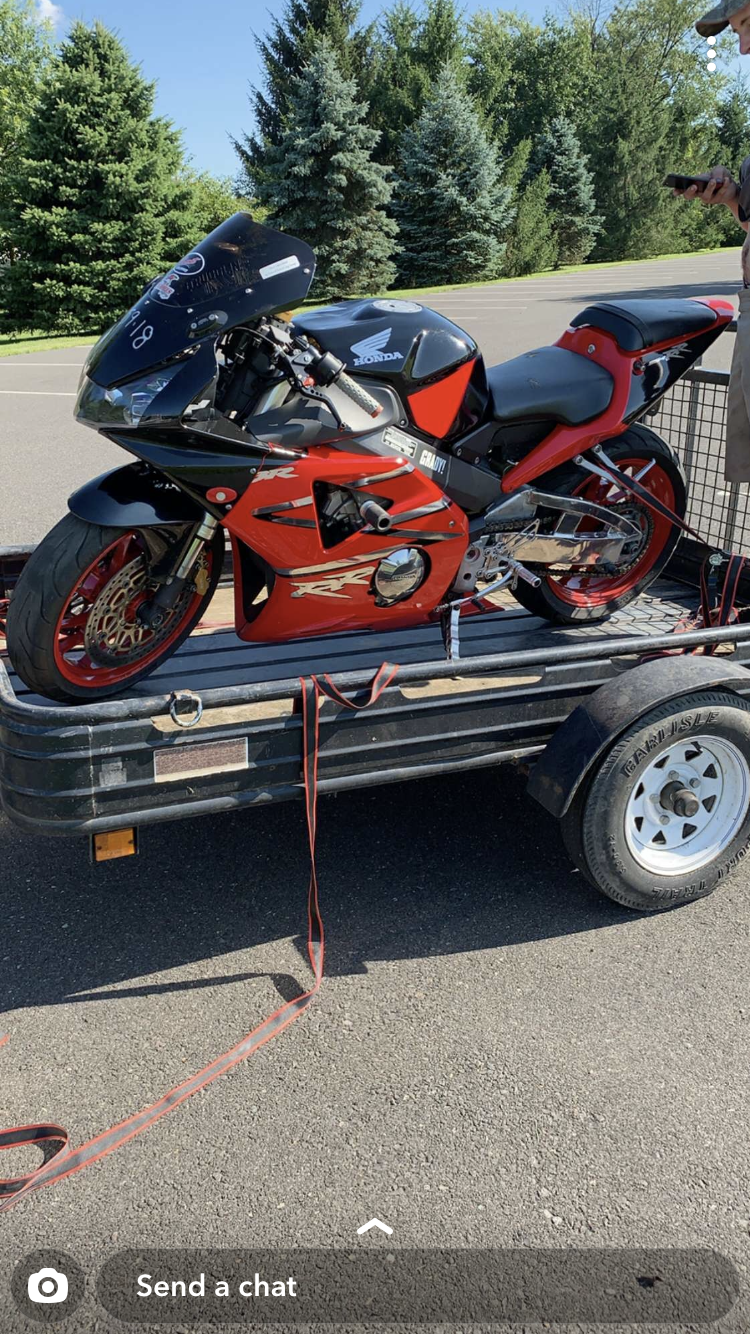

Rings gave up on my 954 at 23k, trying to only have it apart one time, getting the cylinders re nikasiled and running 1000rr 13.5:1 pistons, is it worth boring to a 980? I was told to run an 06-07 cbr1000 intake cam on the exhaust side and a custom grind intake, anyone know where I could send the 1000 cam to get the cam position sensor welded on and balanced? Will dual valve springs on intake and exhaust side be stiff enough? Open to suggestions and opinions just trying to learn as much as I can about these engines. Just joined too so here’s a few pictures of my baby, thanks in advance!
