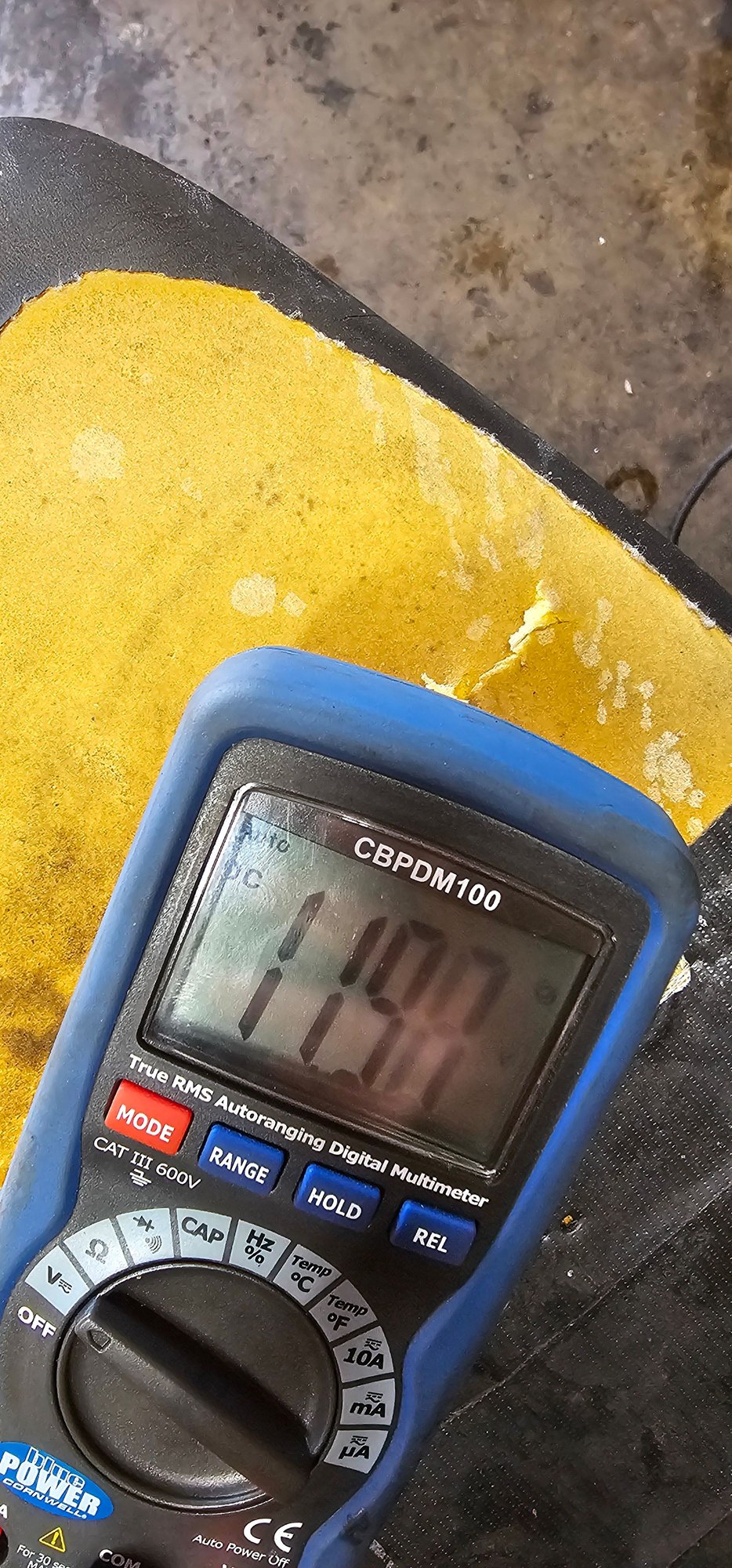

I battery was 11 as well same with Fuze box wire and ignition all of it was 11 yes I have adhd but I've worked on planty of bikes there is no need for u to act like this I just am confused
1:battery voltage is 11
2: fuse box voltage is 11
​​​​​3: ignition blk and red wire is 11 same as for red wire 11
4: FUZE BOX IS 11

my first time doing this and u wanna act like that every thing i tested in your Lil guide was 11v now what's next bucko

Charge the battery - you're looking fire a battery voltage of 12.8 at the very minimum.

We had its up to 13v it was on a jumper but I'm just confused on how the ecu plugs have no power except the pink wire
