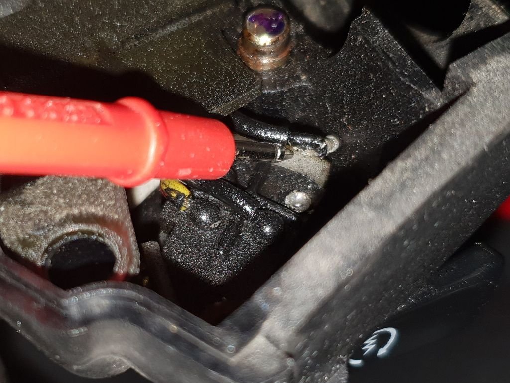

As it turns out, my headlights died yesterday (seriously cursed with this bike lately) and turns out its the starter switch (which was a fun little wiring hunt), so im going to buy a new starter switch assembly anyways and i can buy them together but those parts tend to take a while to arrive (from the US to Aust).
The starter switches can get gummed up and stick down just enough to kill the lights. Ask me how i know.... Little cleaning and lube is all it takes.

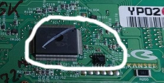

Up until the last year, i've not really had a reason to poke around in the electronics of the bike, but what i have seen so far often makes me wonder about the reasons behind some of the design choices... no idea what the mechanical side is like on the CBR, but the electronics are truly strange in the extreme in many cases. Would love to crack open the the ECU and the dash now just to see what they've put in them though I Imagine someone probably already has.
Oh right, thanks for that, figured it would be a completely custom part or something.
Would be really curious to know the part numbers on these two chips if you do get a chance (or some close up photos of them):
Thanks in advance!
