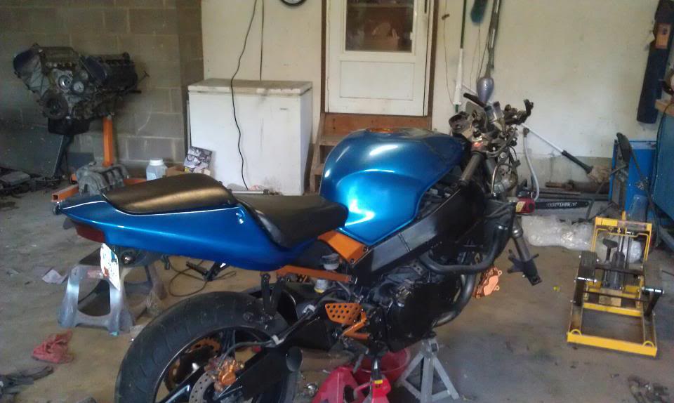

I had a slight course correction. No one (including me) was digging the white, so we changed...

You like a challenge!
It's looking good. Keep us up with the progress.

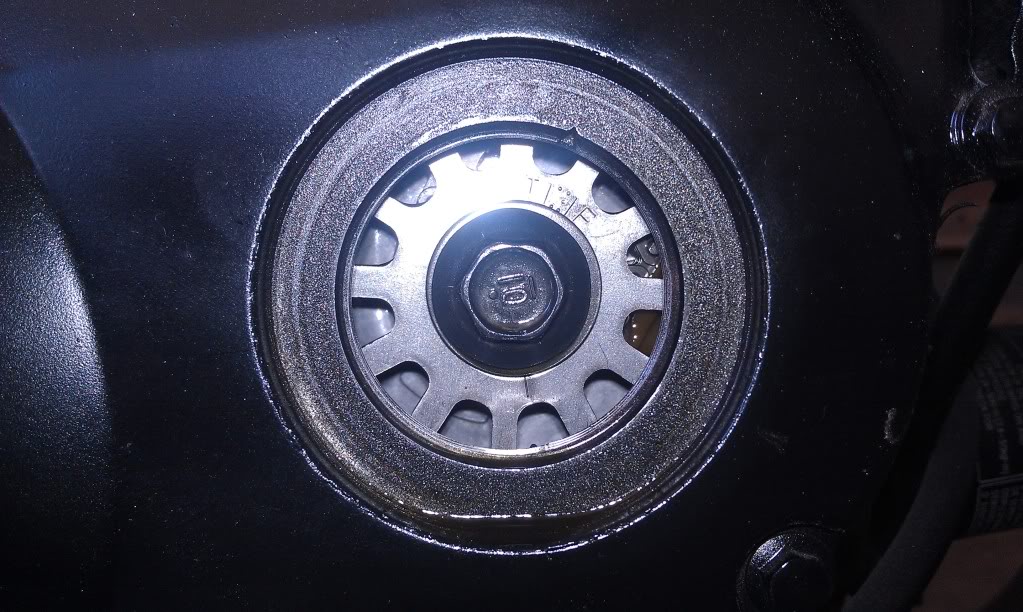

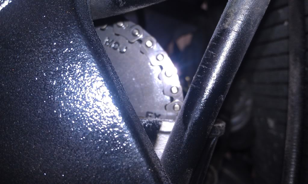

She might be a little out of time.

She is alive again! I finished up shimming the valves, installing the Ape cam chain tensioner, and installing the 954 throttle bodies. I fired her up and was met by a much nicer idle. I'm very, very happy with the progress.
