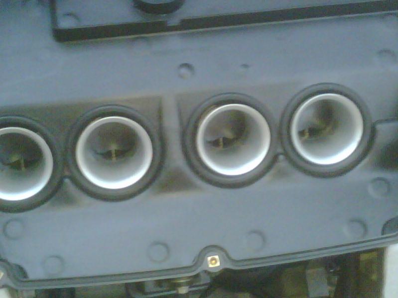

hey fellas wahts up i just take the tank out and check the air filters and look ok but smell like fuel on it,also the carburater box is kinda smell of gas but the carburaters theyre not dirty much just abit arround so i clean them,i was cheking and cheking and on the top rigth corner in the airbox is a line there and that line was off and dirty so i clean it and i conected it into the airbox i hope that is the whole deal ,i think i was missing some air or something,but it was disconected it from the airbox i found the clamp on the bottom of the line and i installed it so tomorrow i will put the tank back and the other lines in the petcock and fired up see if works,im positive about it,like exiter said i was missing some air i think.thanks and i keep u guys in touch see waht going on.I forgot to mention that i try to find the fuel filter but i cpouldnnt see it at all,is 900rr 1998 i know that model dont come with fuel pump but i dont know about fuel filter,thanks again.here some pics,the first one is the line that it was out from the airbox,and u can see the tha airbox wasnt that dirty just on top abit,,thanks again.
Attached Thumbnails my bike wont start.-img00981-20110816-1924.jpg   my bike wont start.-img00982-20110816-1924.jpg   my bike wont start.-img00983-20110816-1925.jpg
