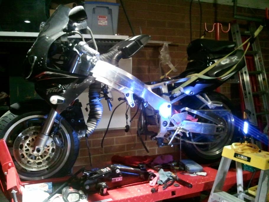

OK so my winter project was to strip down the engine do rings, bearings and valve seals amongst other things. no big deal i thought
Engine out bike no big hassle

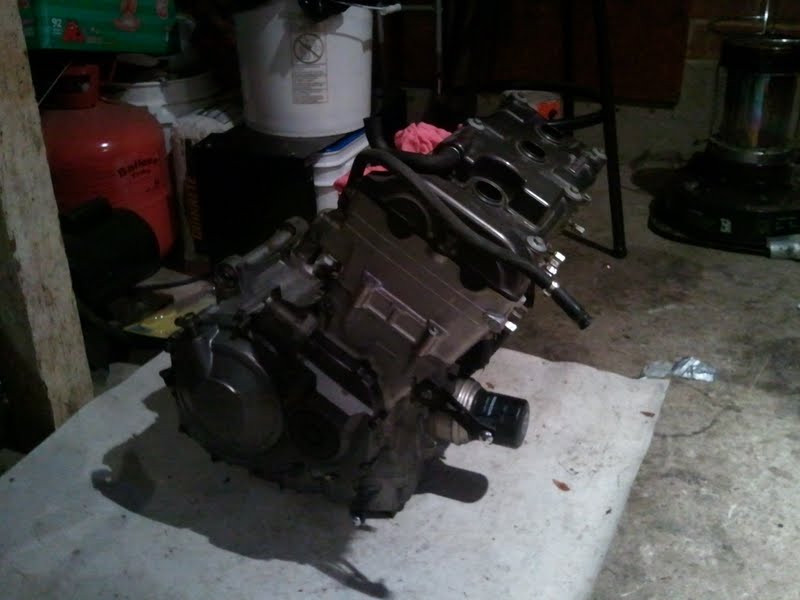

engine on the floor ready to get set up on the bench........ letting the strip down begin.

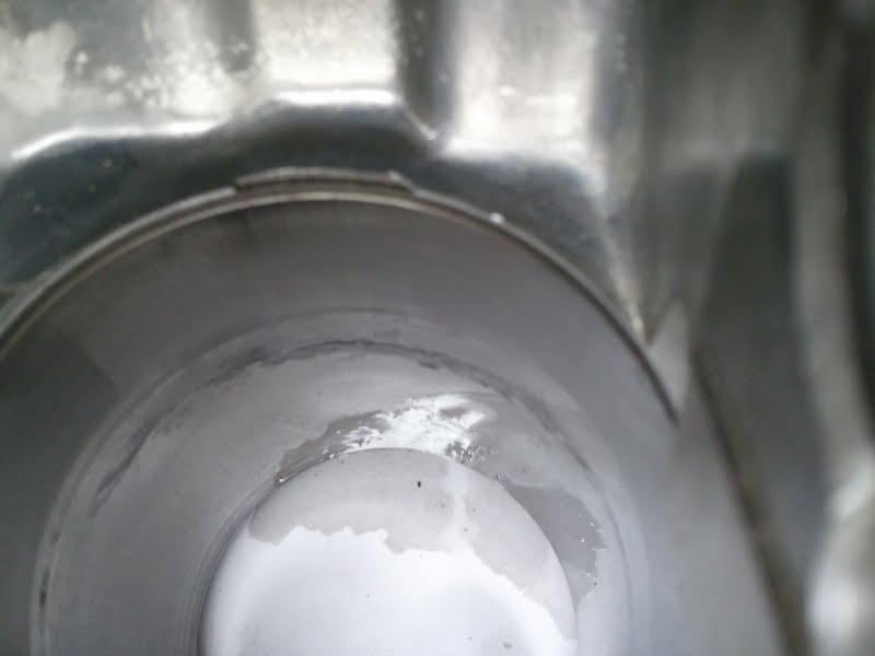

and the project grinds to a shuddering halt.
cylinder no4 heavily pitted and scored just above the start of the bdc cylinder stroke.
so resleeve or try and find a replacement case with good cylinders? Or replace it with a 919.......... what would you do??

i would try and sleeve it and get it running good before you try to get rid of it. just so you know your passing on a bike in good running condition... then get a 954... thats what I would do or try to part it out (could take a long time, I dont know many people looking for 900 parts) and get the money to get another bike. you have a couple options just please dont pass it on the way it is.
but its your call your bike i have had many setbacks on my winter project but I worked through it and so can you. good luck and god speed let us know what you decide

If I were you I would look at the cost of each option, taking into account the benefits and drawbacks of each.
For example, a benefit of the re-sleeve is you will have a fresh motor that you know will last. A drawback might be the price involved.
At any rate, let us know how the project progresses!
