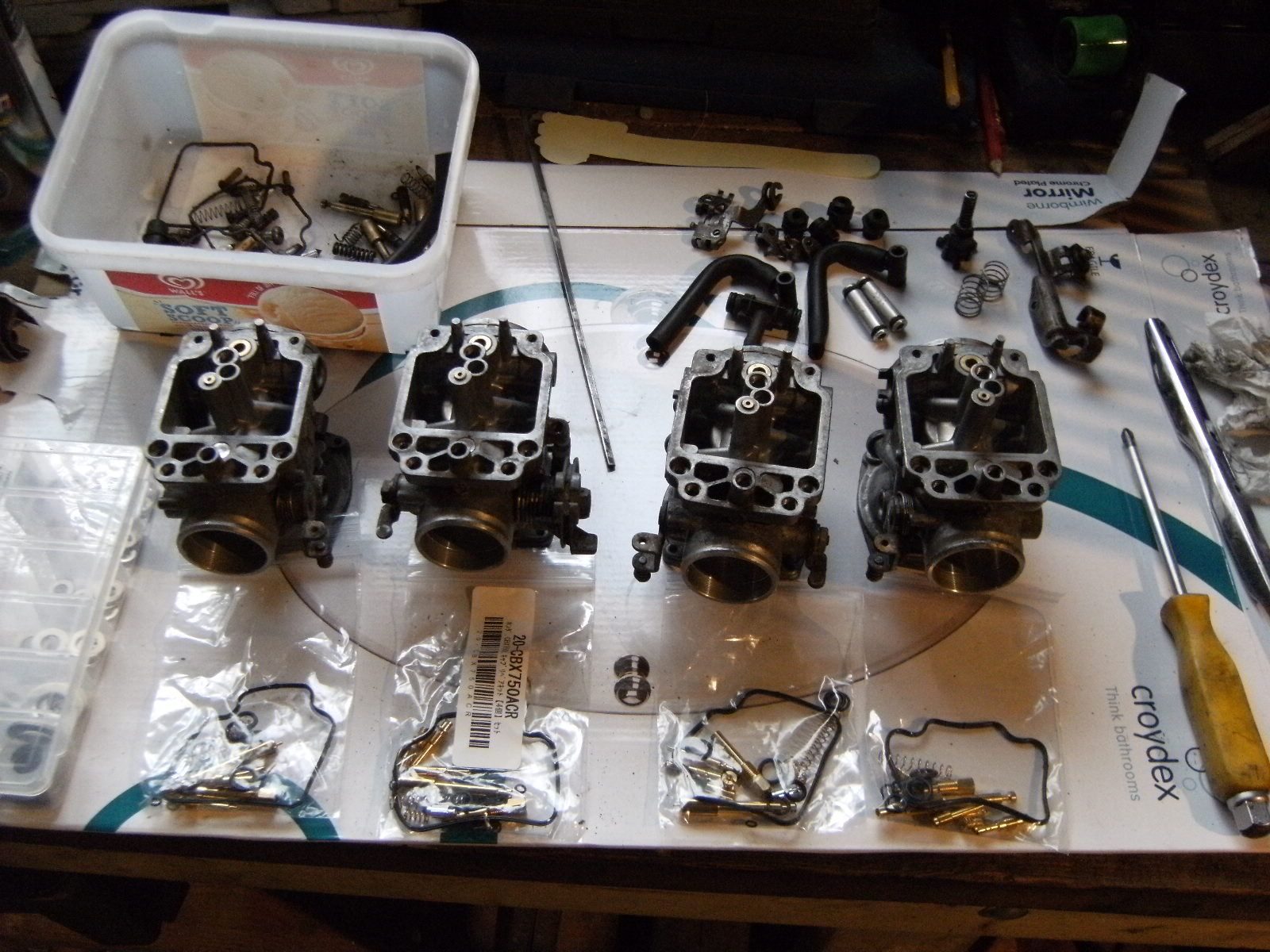

Hi you could have done a total dis-assembly ,but that might have been a step too far, those small sync springs are a bugger to get back in, you need three hands

I didn't think even a disassembled carb body would fully fit in the 2.5L ultrasonic cleaner. I had no illusion that the size cleaner I could afford would fit the full rack of four carbs. If I'm lucky though, perhaps 2 bodies will fit in the 15L unit.
Carb disassembly / reassembly was actually pretty straight forward (and that's what I'll probably do anyway to maximize cleaning potential.) But, like you said, those bloody little springs between the carbs... (I think I surprised the neighbors with my richly diverse and colorful vocabulary.)

Yes I would like a Cleaner myself, might even get one But up till then it's a breakdown and clean the best I can, but I make sure with new kits
