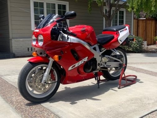

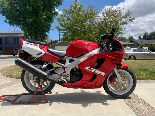

The 900RR project has greatly exceeded expectations. Had some fun with doing the work and learned both how to do stuff and not to do stuff. So FWIW, here’s a bit of both. In the end, I now have a classic CBR that is an excellent bike by any measure.
I started with a complete, early 900RR that I’ve owned since March 1992. I rode it for 12 years or so, then let it sit – covered and protected - while I played on other, newer bikes. Only 16K miles. So I knew the history and the mostly straightforward work that it needed. Most restoration projects probably start with bikes in need of more serious repair, so I had a bit of a head start. But even bikes with only “minor neglect” of just old age can require a fair amount of work – brakes, forks/shocks, carbs, anything with seals, and *lots* of cleaning/rust removal/repainting.
My goal was/is to restore the bike to its former condition for afternoon twisties and occasional track days. It has plenty of power and the S21s are certainly better tires than were available back when.

Overall, I’m really happy with the 900RR. After my extended dalliances with two R1s (the 2015 was a fantastic, though a physically demanding bike) the CBR is so much fun to ride. Am looking forward to track days to see if I can get back to decent lap times. Now that I have a sport touring bike (Kawi 1000sx) for long trips, I can keep the CBR for its intended purpose. It still is a great bike and I am really glad that I never sold it.

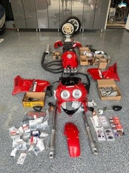

These are still great looking bikes
From any angle

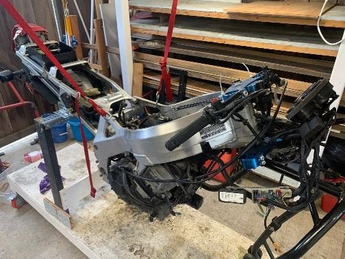

Didn't have to pull the motor, but most everything else came off
Parts is parts!
