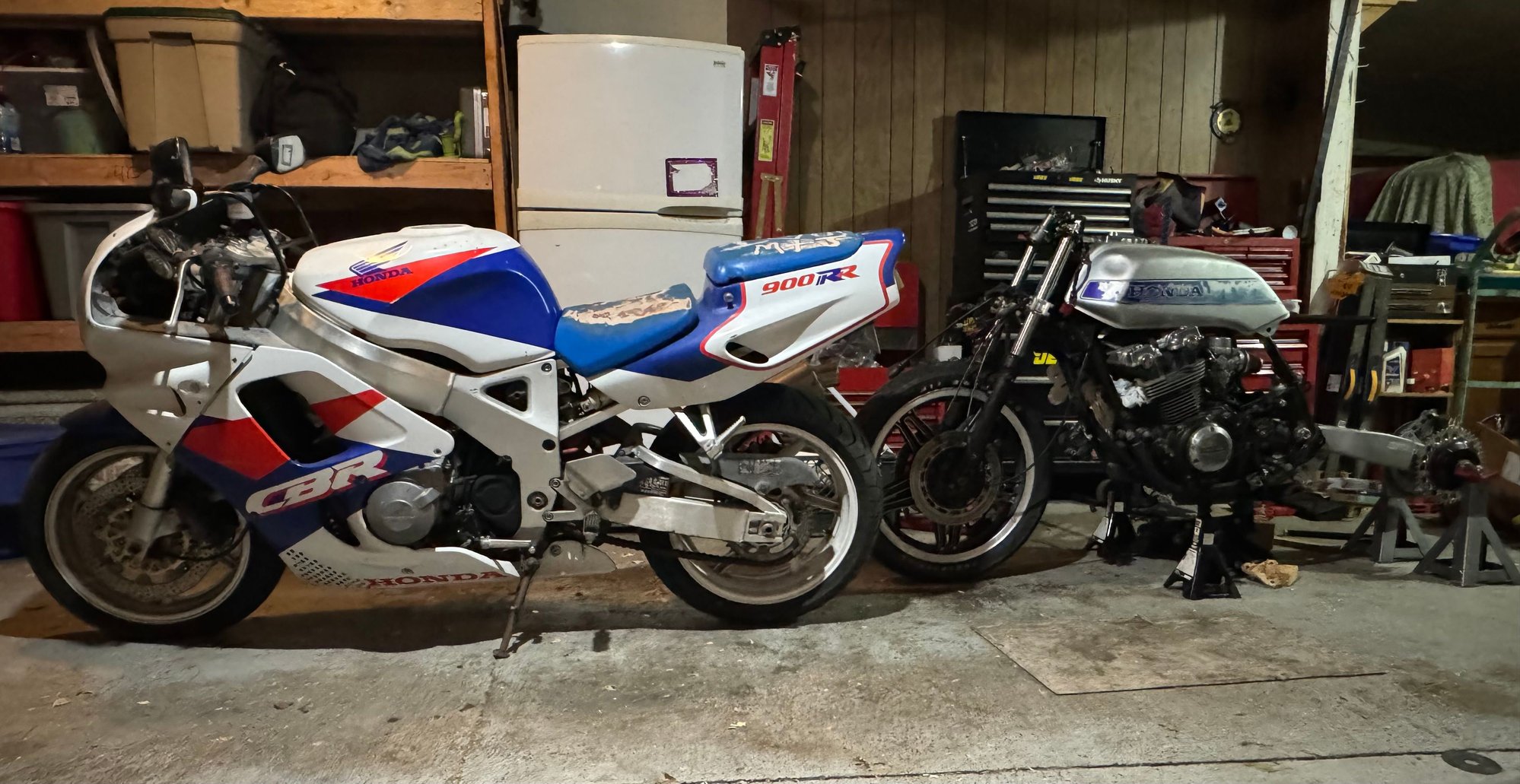

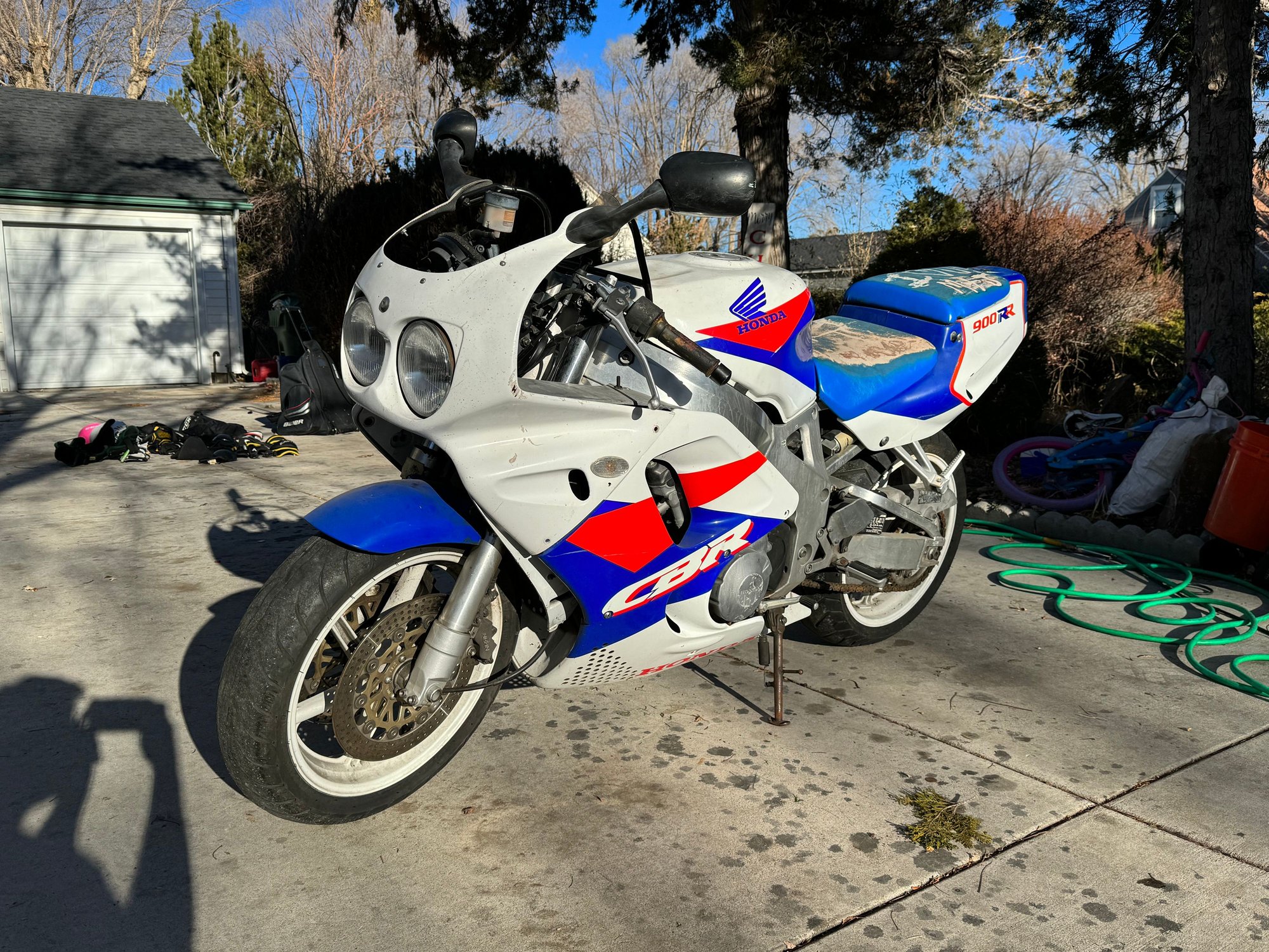

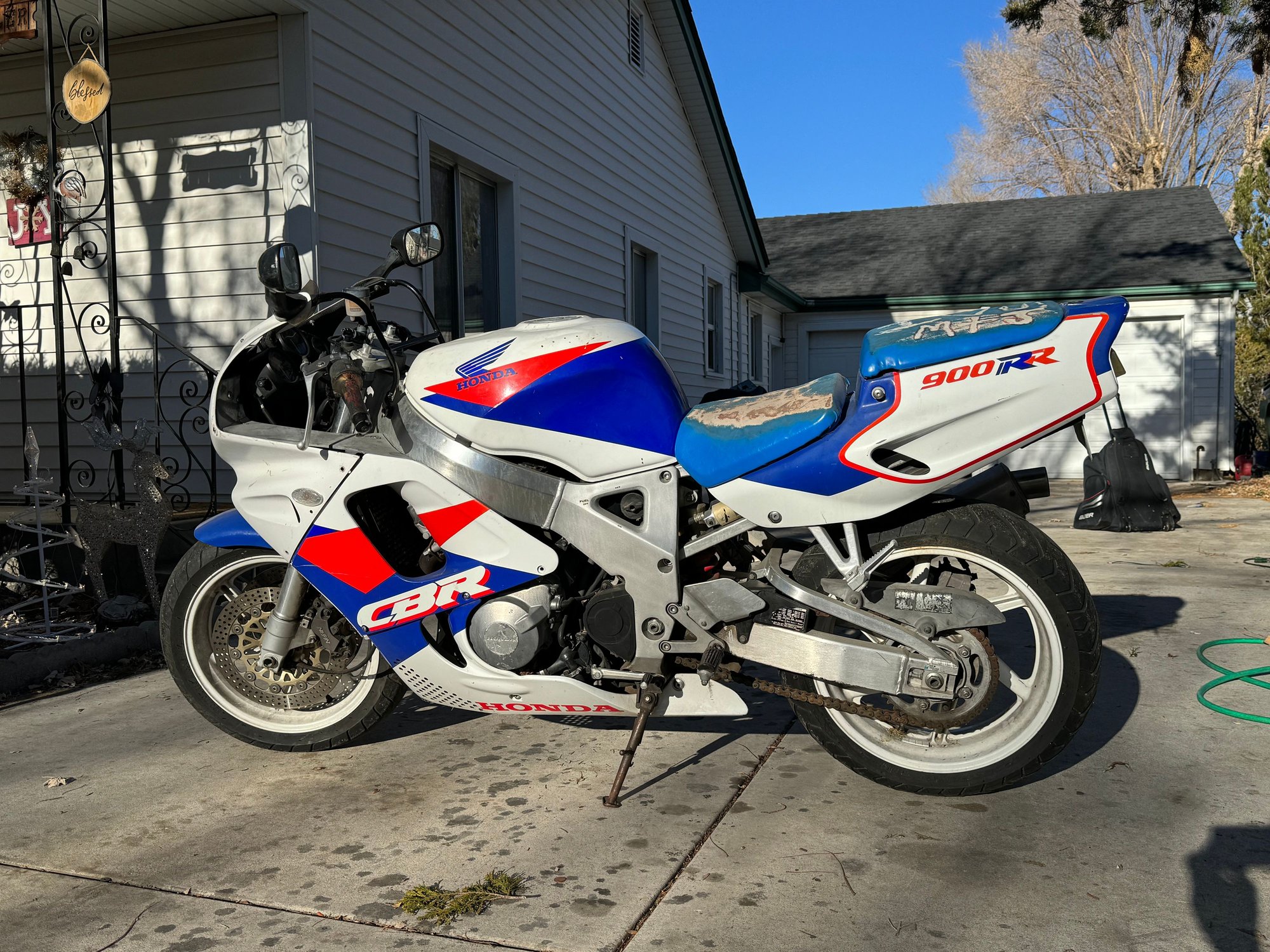

Popped up on my Facebook feed and couldn’t pass it up. Been sitting since 2012 so the carbs and fuel pump are like molasses. Engine moves freely, changed oil and coolant and they look great. No frame, swingarm, fork, or engine cover rash. Ordered new fuel pump and pulled the carbs to rebuild and replacing fuel lines atm. Any secrets to dissolve the gummed up fuel? Anything else I should do to get her back in order?
