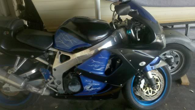

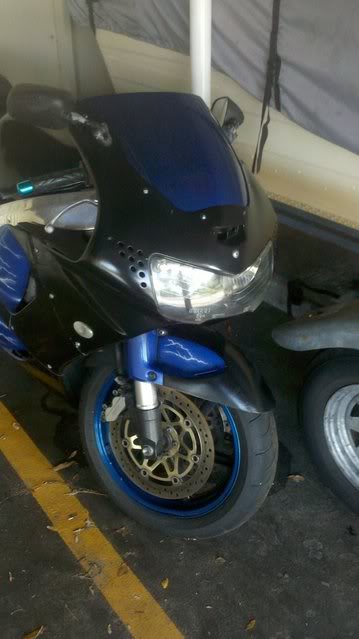

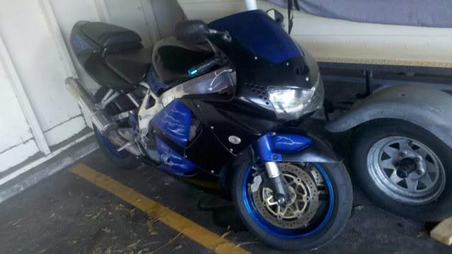

i just picked up a 1998 CBR 900RR, it needs a little bit of work, but i should have it running shortly, i know it has a leak inthe tank, and has sat for four months, so im going to start by fixing the tank and checking all my fluids/plugs/brakes and lights, any suggestions/pointers are greatly appreciated...on to the pictures, ill get more/better pictures tomorrow

aaaaaaaaaaaaaaaaaaannnddd, my worst nightmare, it has rod knock, ugh, so a rebuild is in order, guess ill get to ride it next summer :/
to anyone reading this, is there anything other than the crank and the bearings that i should give a once over while im in there, ive rebuilt the engine in my integra, so i have a mild amount of experience. i guess im currently in the market for a new crank and bearings and a gasket set, not the way i wanted this to start, but hey when im done itll be basically brand new
