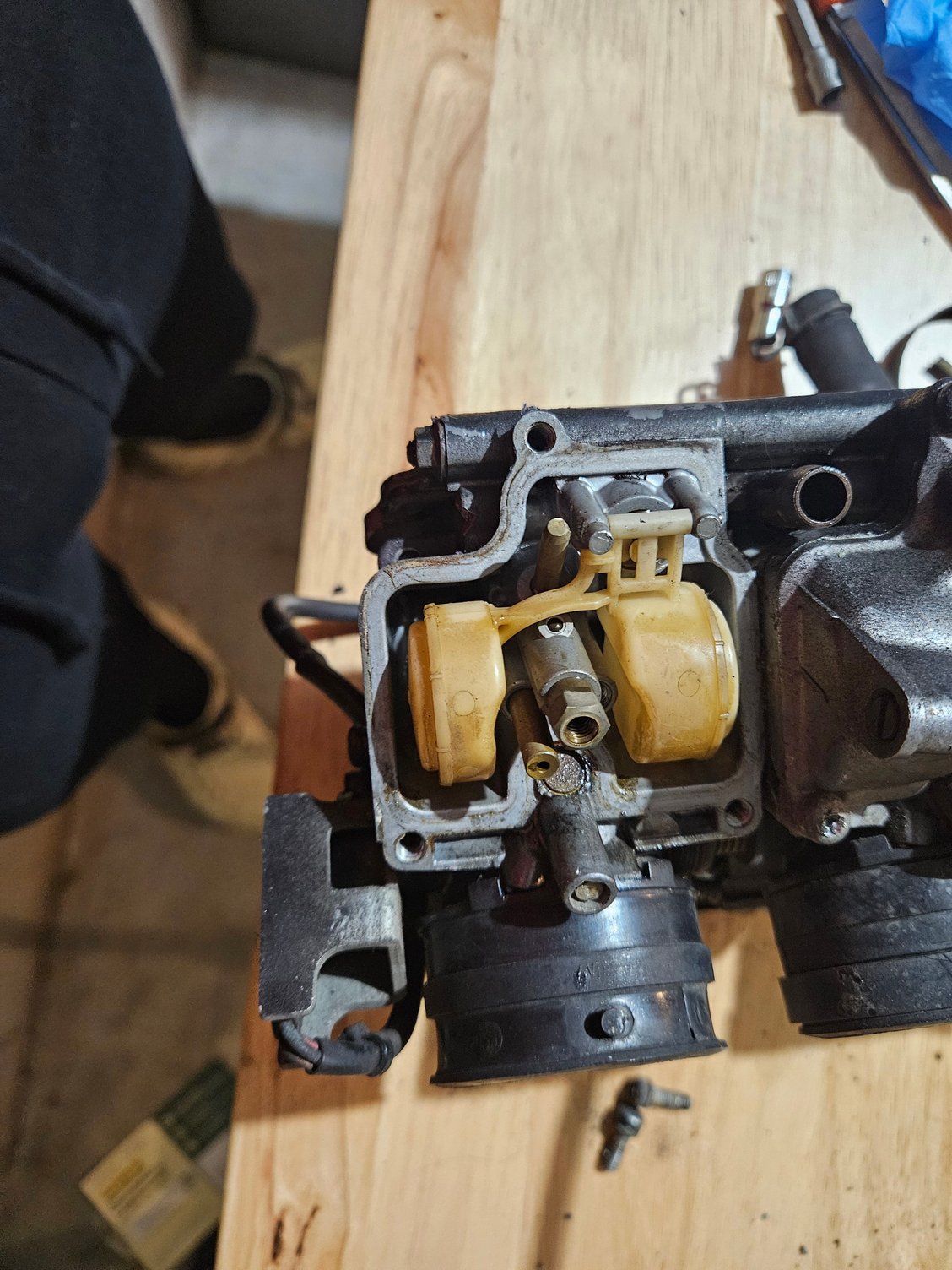

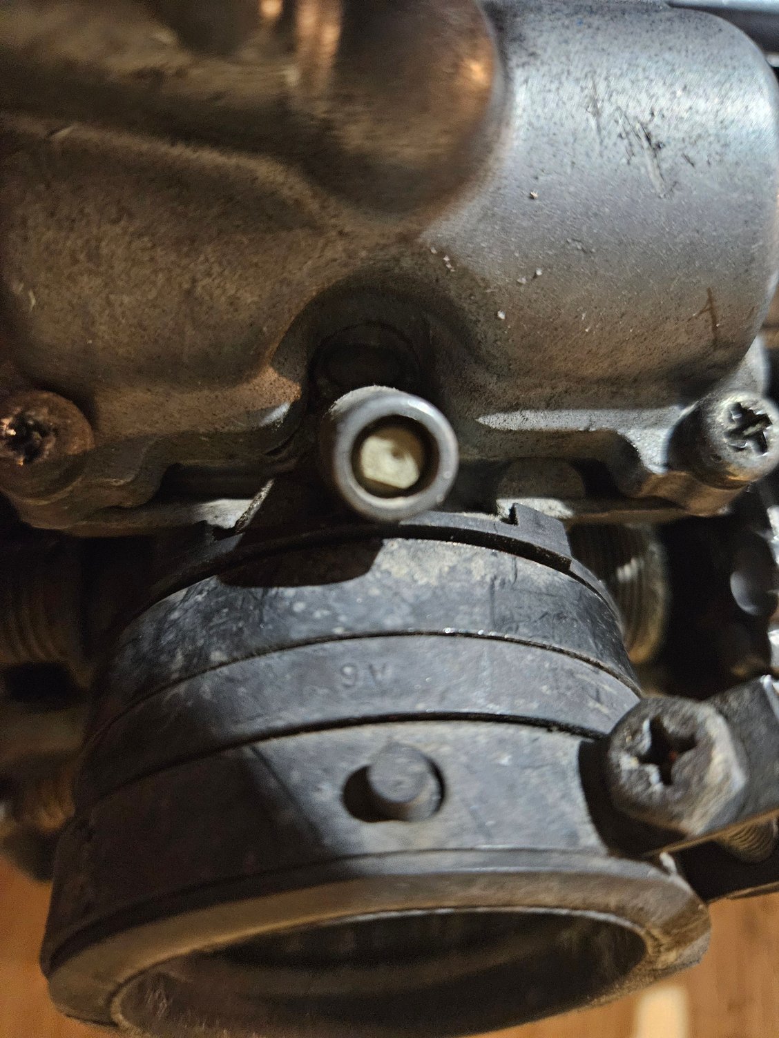

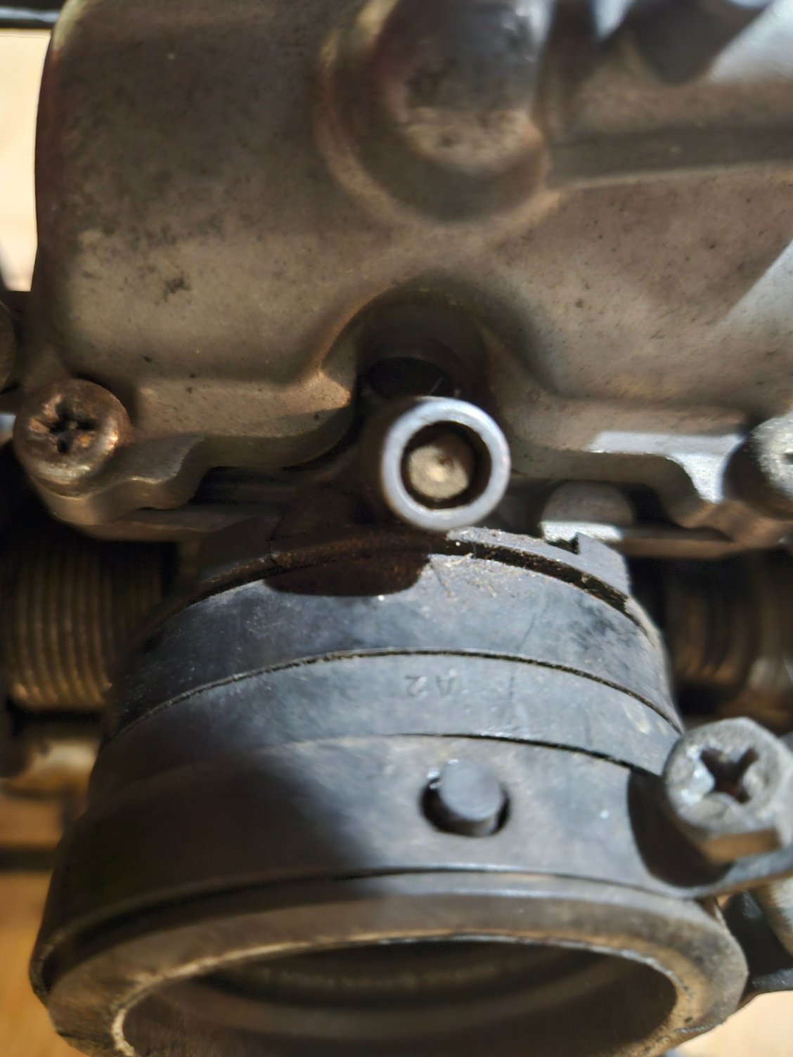

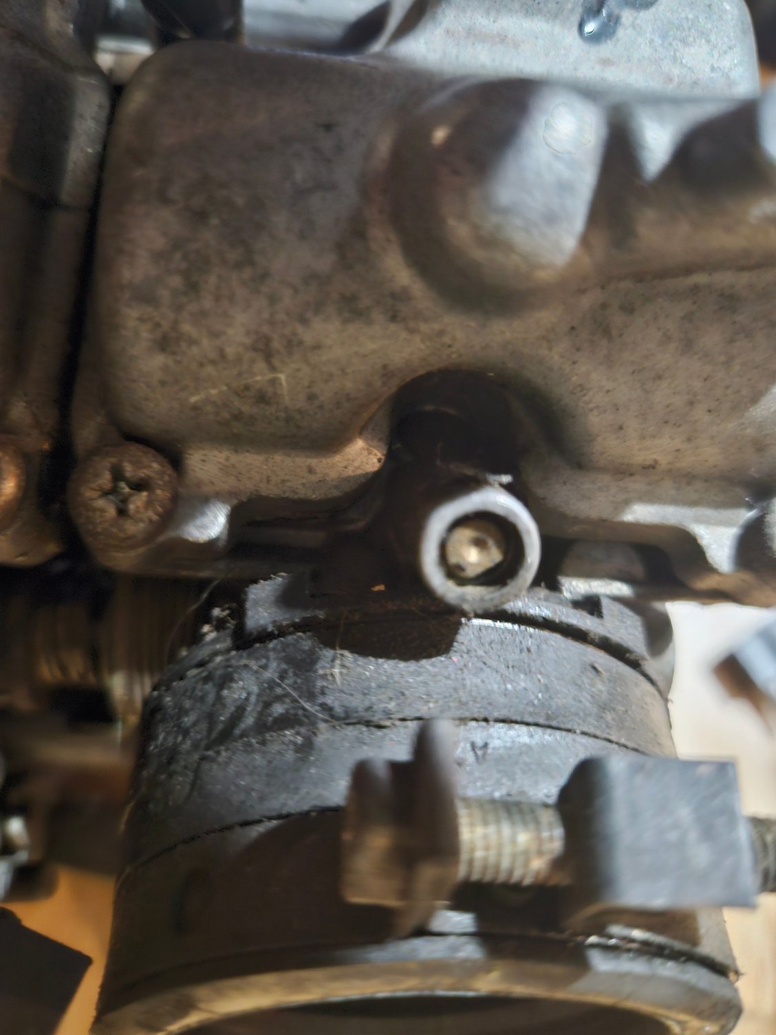

So i just recently picked up a project 900RR and while going through it i noticed id have to deep clean the carburetors. The problem i found was a set of screws on the individual carbs that are typically flat head screws are some other type of screw. I have been stuck on this issue for 2 days now and Youtube has nothing on it. Does anyone have any ideas? and or advice going forward? New to motorcycles by the was so i don't know the exact name of parts.
the first 3 pictures are of this mystery screw, the other two is how just one of the carbs look.

Get this tool or make one yourself.
https://www.rockymountainatvmc.com/p...l-screw-tool-p
Set it to 2-turns out when reassembling.
