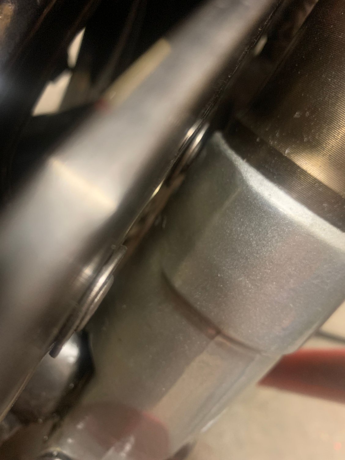

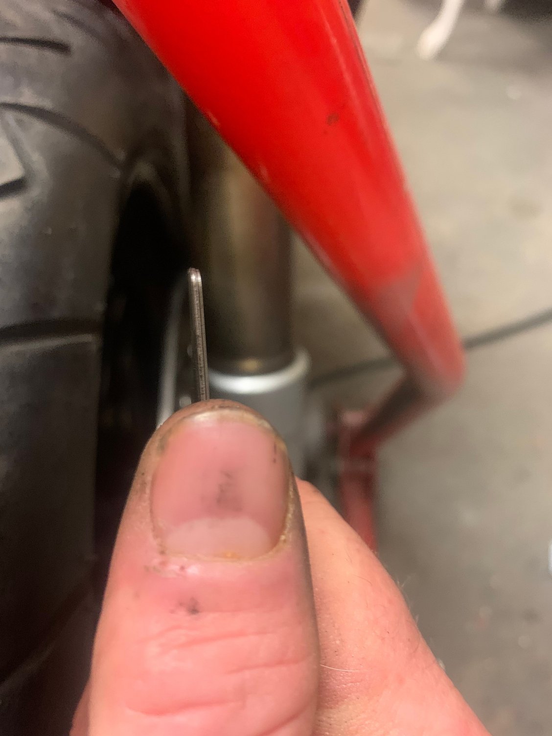

fitting wheel to procedure in manual. After all torqued up this is what I’m left with. Rotors not sitting Center of calipers so binding occurs. Right caliper is tight with rotor on inside pad, left is tight on outside pad.
nothing looks bent. All I can think is I have the wrong spacer in right side. Or a small spacer missing on the left side ( speedo drive side )
im stumped?????
So if sitting on bike. This is the clearance between rivet on rotor and fork leg on left side.
Sitting on bike. Left side.

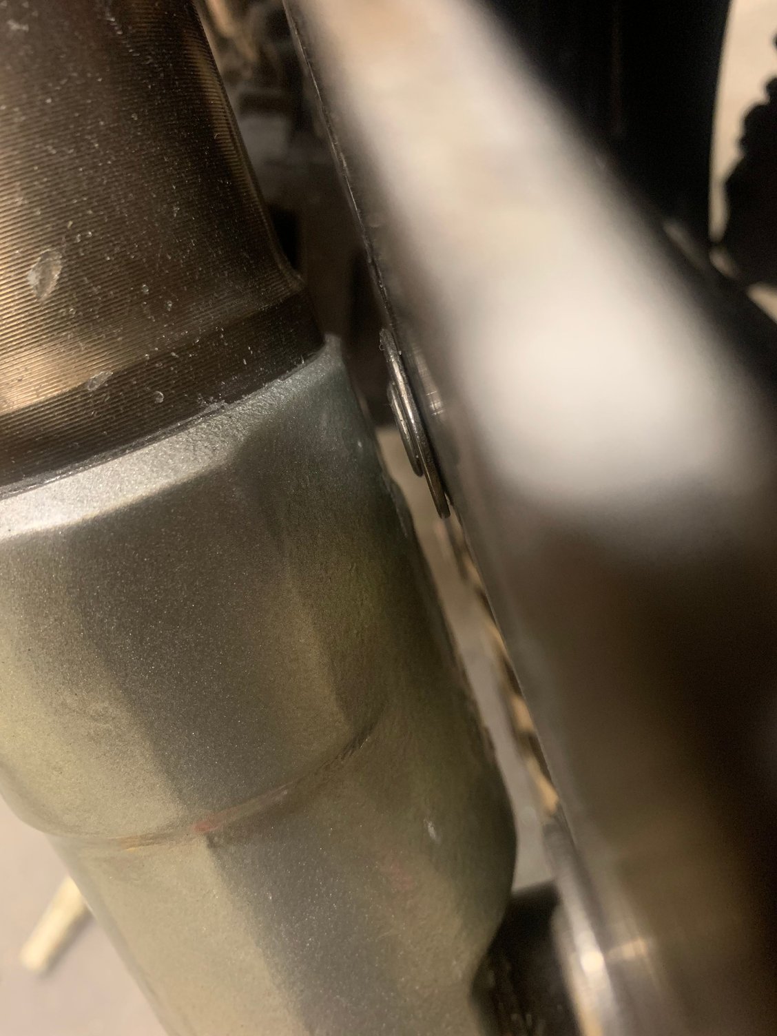

Sitting on bike. Clearance between rivet on rotor and fork leg right side.
Sitting on bike. Right side.
