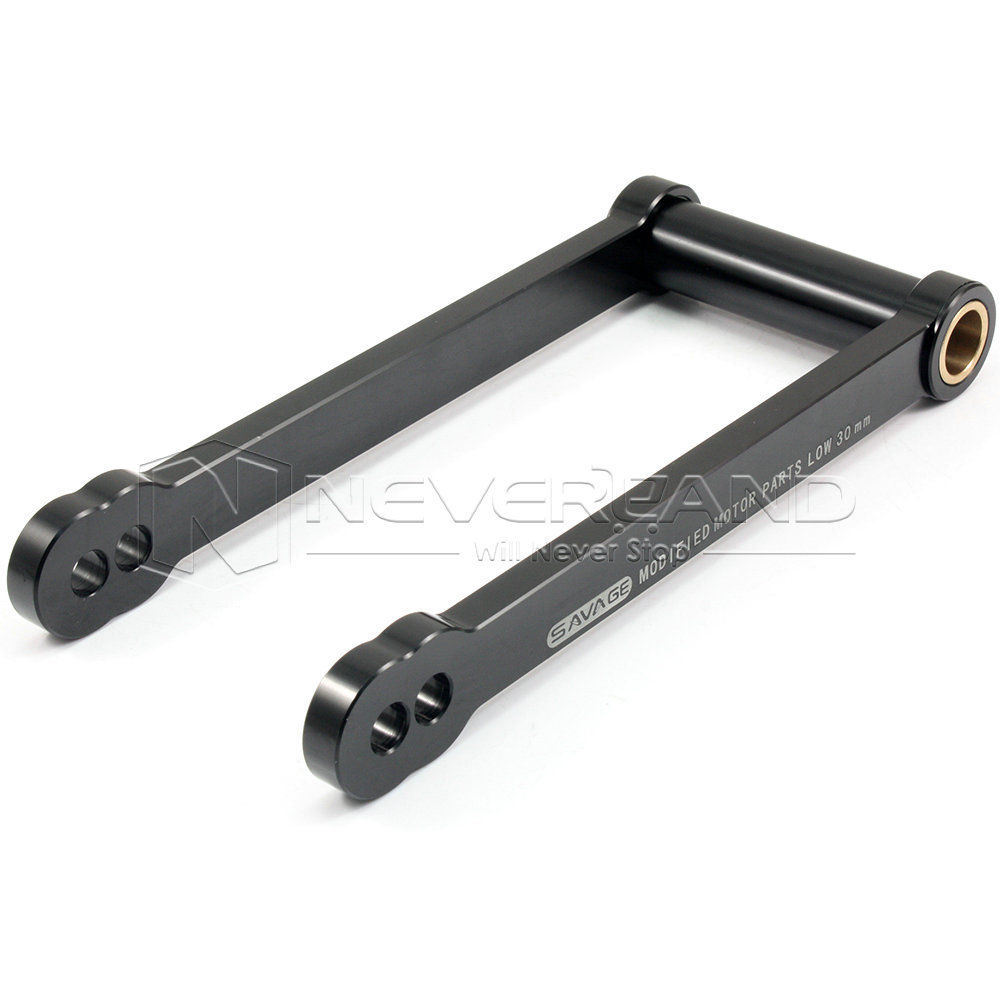

Hello I'm new just got my first big bike! It's a cbr 600rr and I can't touch the floor confidently I'm on very tippy toes!! I've brought a lowering kit off eBay and fitted it and it hasn't made no difference at all!! The dog bones are the same length as the standard one that I've took off! So I'm guessing they've sent me the wrong one?? Can anyone please recommend what lowering kit to get as im 5 foot 4 and very slim build and weigh 10 stone 3, so ideally I want to drop it about 3 inches ? I don't want to risk buying another lowering kit myself and risk it being wrong again!!! Any help would be appreciated!! What lowering kits do people recommend?? Thanks!!!

Wassup man, you should have 2 or 3 holes to choose from! First hole should drop 2 inches, 2nd hole 3 inches, and 3 re hole should put you very close to the ground! Could you post a picture of your links?
