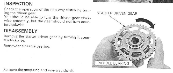

The starting clutch is what transfers the drive from the starting motor to the engine. It allows the engine to turn and not cause the starter motor to continue rotating. It is often done by way of a one-way bearing. It spins freely in one direction and locks in another. Yours may be bad.
https://www.partzilla.com/catalog/ho...tarting-clutch
Old Jul 17, 2022 | 02:12 PM
Stewal's Avatar
Joined: Jul 2022
Posts: 21
Okay thank you
Am I looking for part #8 Bearing, Needle?
Old Jul 17, 2022 | 02:13 PM
The starting clutch is located behind the Right Crankcase cover.
https://www.partzilla.com/catalog/ho...rankcase-cover
