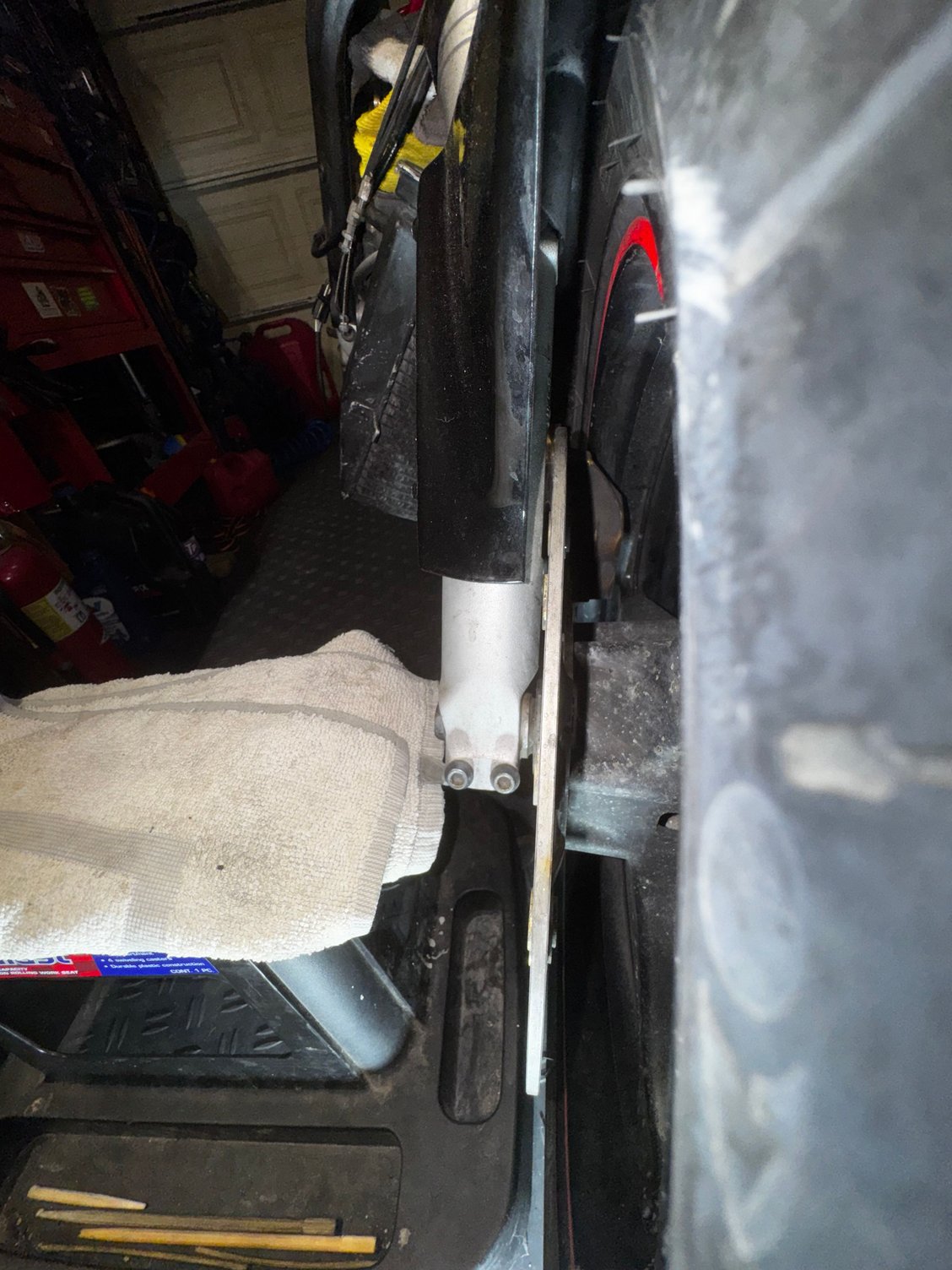

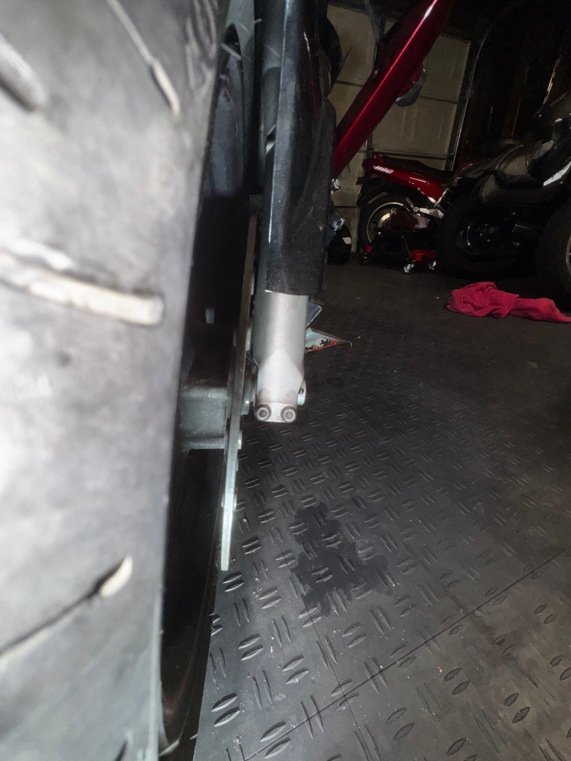

I bought this bike with all the steering gone. I bought forks (MEE-003) and front wheel with the collars (spacers). All the parts check out to my knowledge, but the rotors and the hub distance is 7.5-8mm to narrow.
I am trying to find a RR I can just look at and measure what component is incorrect or missing.
Can someone give me the fork width or the hub width?
Pictures show wheel biased to the left side, notice gap on right and how far the rotor is from the fork.

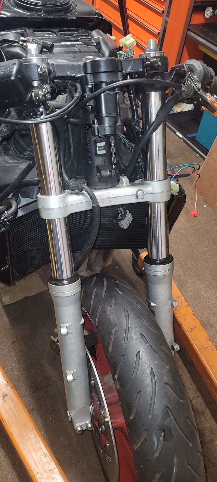

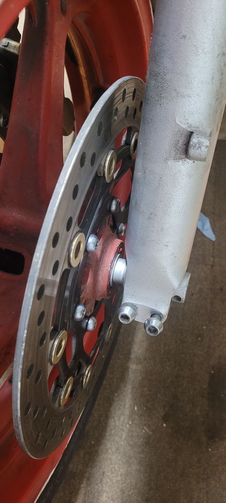

I’m working on an ‘03 CBR600 for someone and, while I’m uncertain if I’m giving you exactly what you need, here’s what I’ve got.

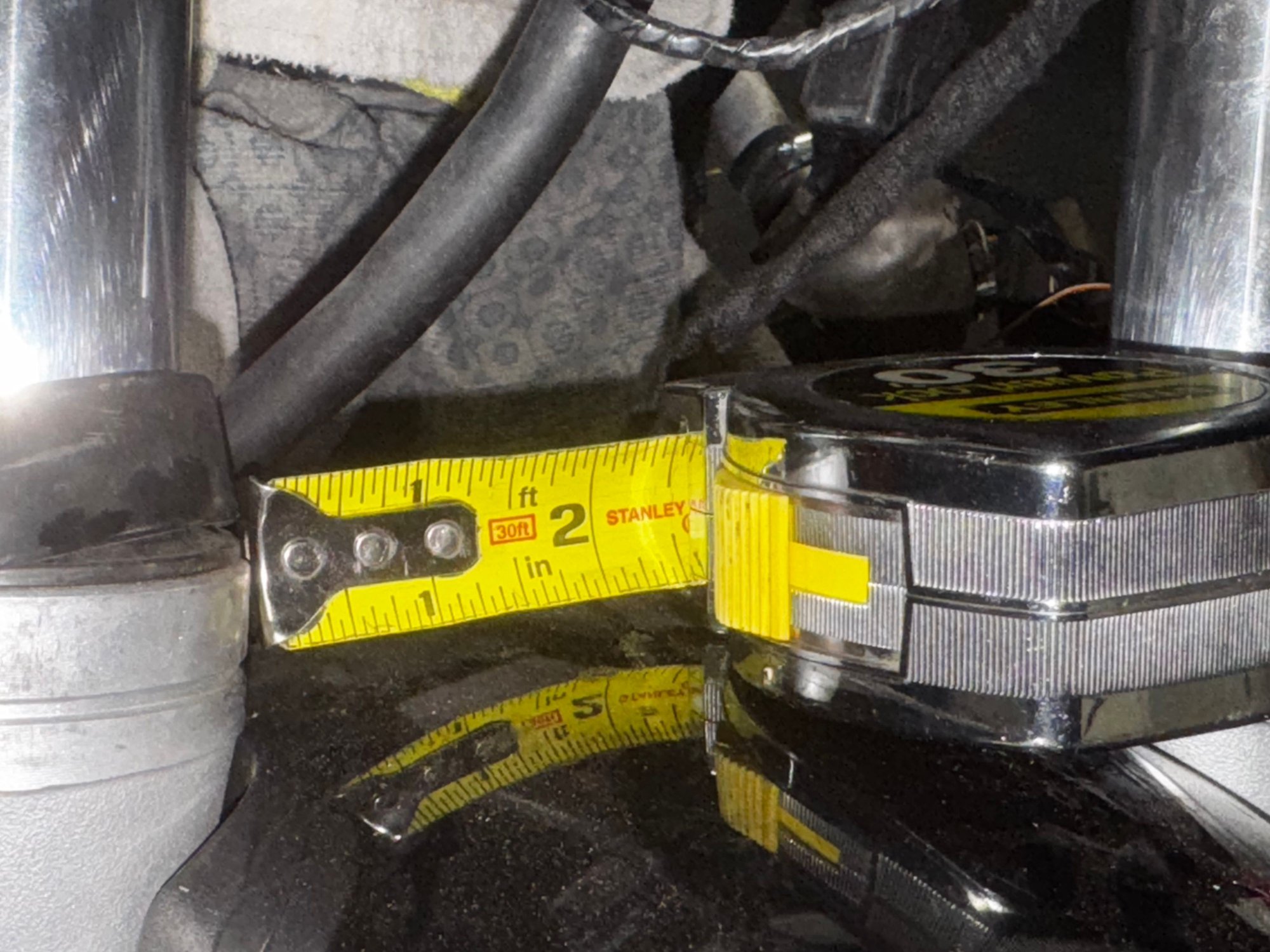

Fork width at top of lower fork is 5 1/2”.
This shows 2 1/2” plus the 3” of the tape measure.

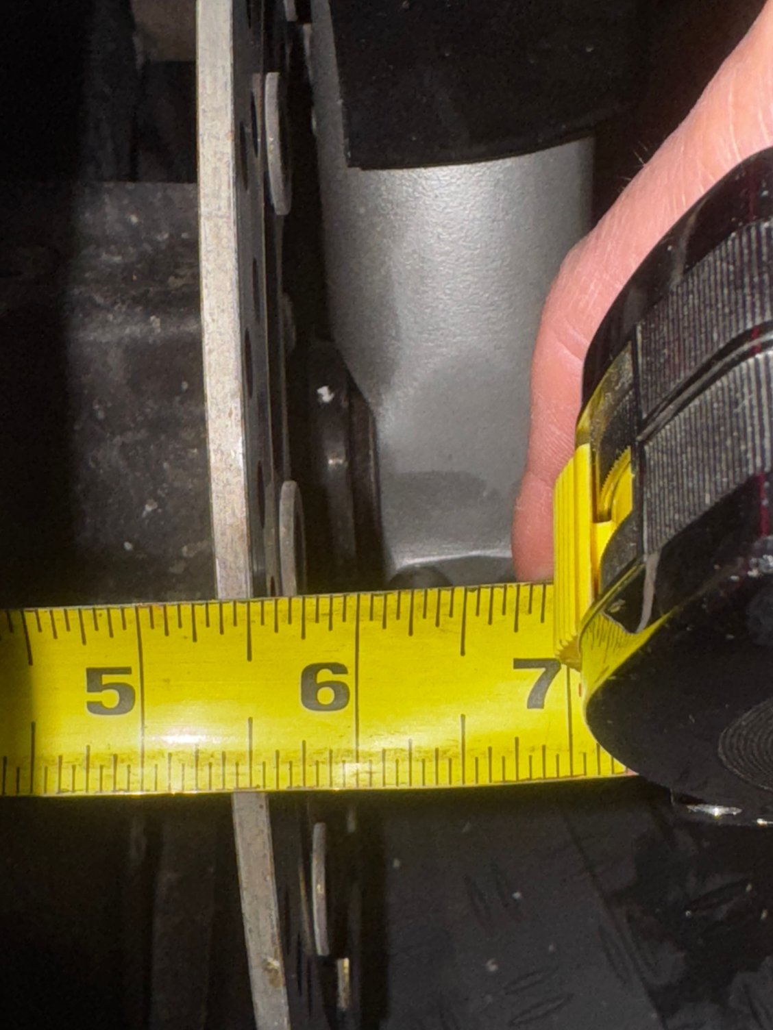

Outer edge of right rotor to outer edge of left rotor is 5 1/2”.

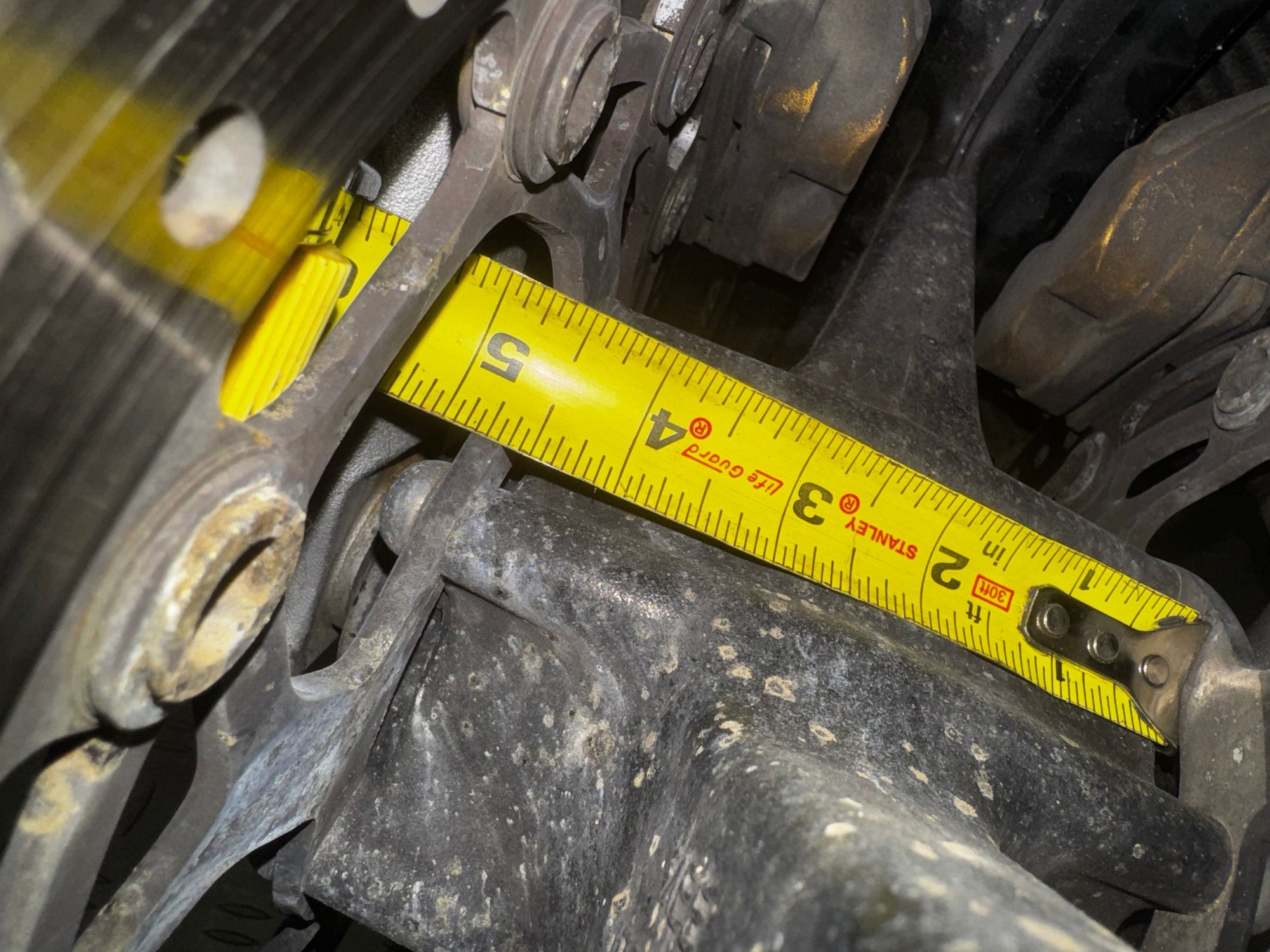

Hub width is 4 1/2”.
Hub width.

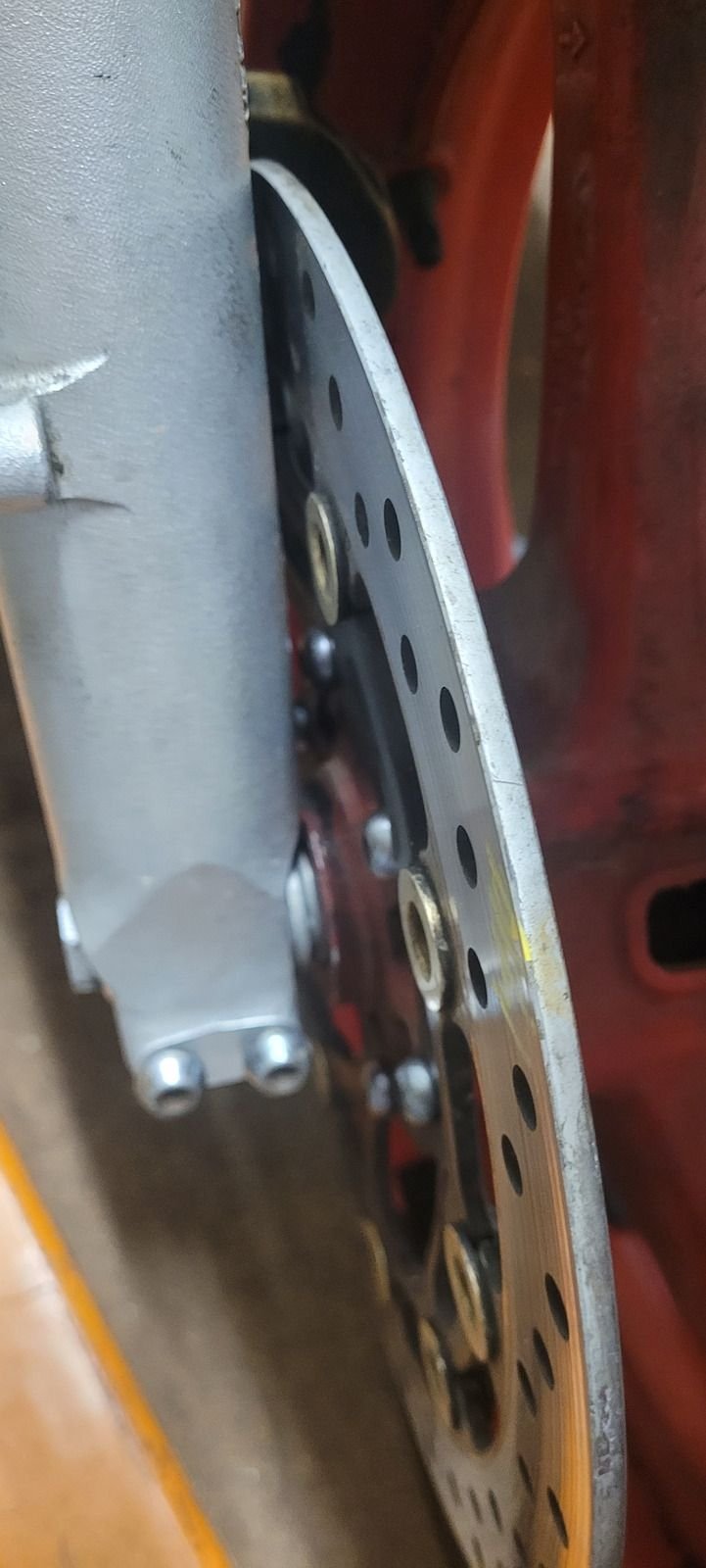

Here are the best pics I can get of distance between rotor & fork:
I hope this helps.
-Sparky
