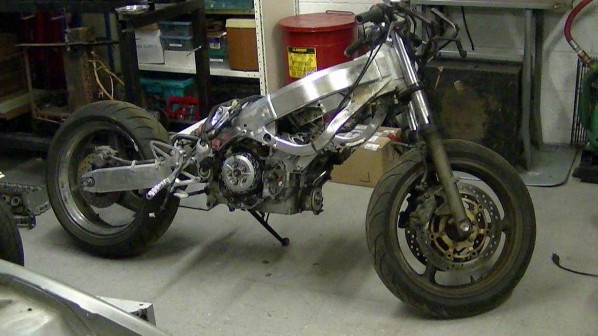

I'm getting a 99 that overall seems to be in decent shape. DMV records confirm ~14,000 miles total.
Story is about 4 years ago it got laid over (not "bad") just enough to bend the lower part of the front fork tubes (tire is pointing off center), road rash the frame in one spot (no dents), and crack the plastic on that side. The guy didn't have/want to spend the money to repair it so it became a "one of these days I'll fix it" things. It then sat for about over 2 years with all the fluids in it and thus became so gummed up that it wouldn't start anymore. Guy started taking it apart to clean it/rebuild it and lost interest. Now a year later he just want's it out of his garage.

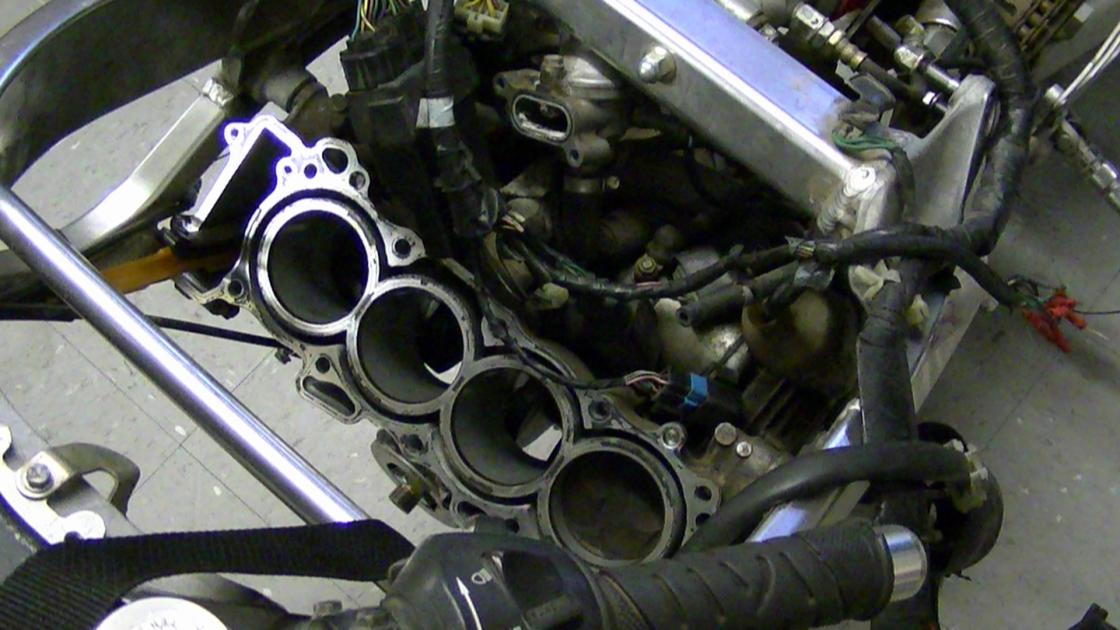

In addition to the "damage" from the fall, when the guy started pulling the motor apart he broke a number of the piston rings (it happens, I have taken enough car engines apart to know carbon/gunk can cause one to crack rings when removing pistons). The cylinder bores look clean (no scratches) so I would think a hone/re-ring should get the motor back together. Also noticed the wiring harness was chopped in a place (perhaps damaged in the fall) so I'll try to find a replacement.

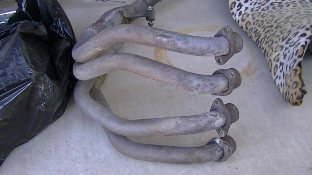

Thanks. Two question came to mind while reading this morning. Do the F4s have CATs and is there an "OBD2" type emissions scan for bikes?

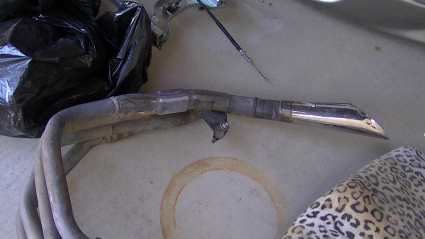

The previous owner of this bike hacked the exhaust right after the header merge and welded a tip on so the exhaust just dumped under the frame. Trying to find out what emissions stuff I would need to put back on for licensing it. From working with late model cars here in AZ, any car 1996 or newer is OBD2 and does not need a tail pipe test, just a computer port check (which means a car CAN pass emissions with no emissions hardware).

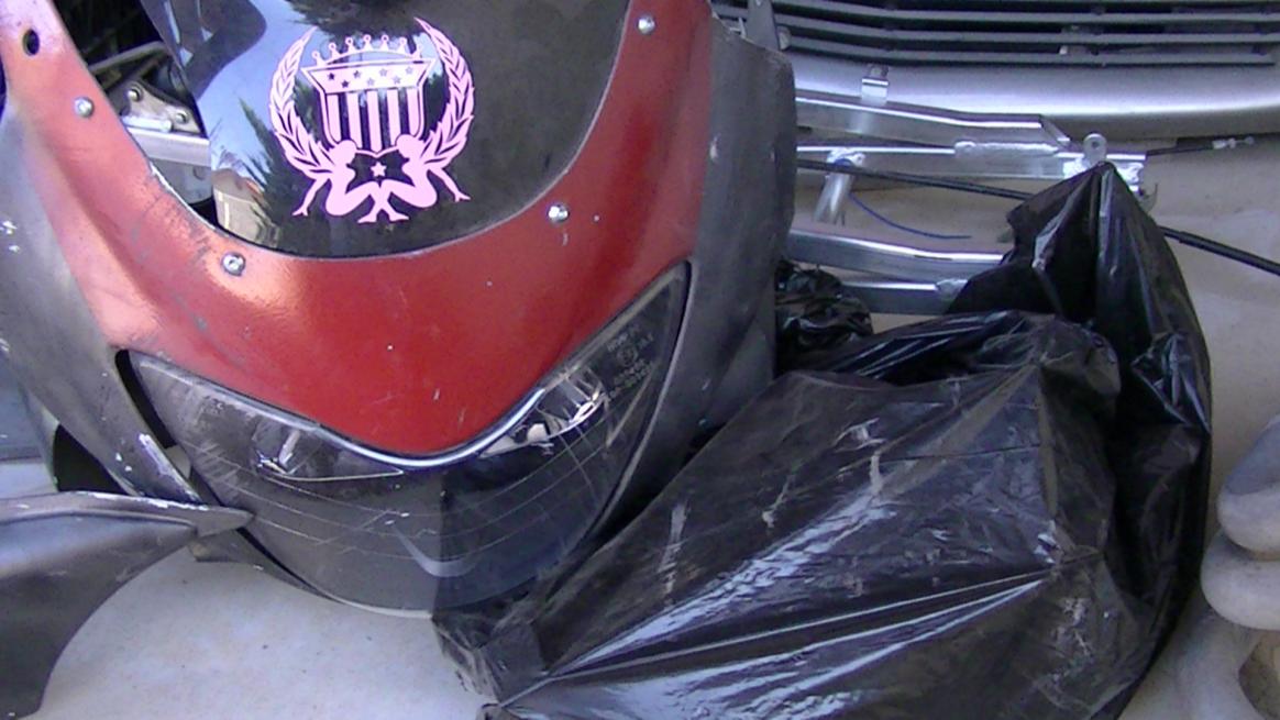

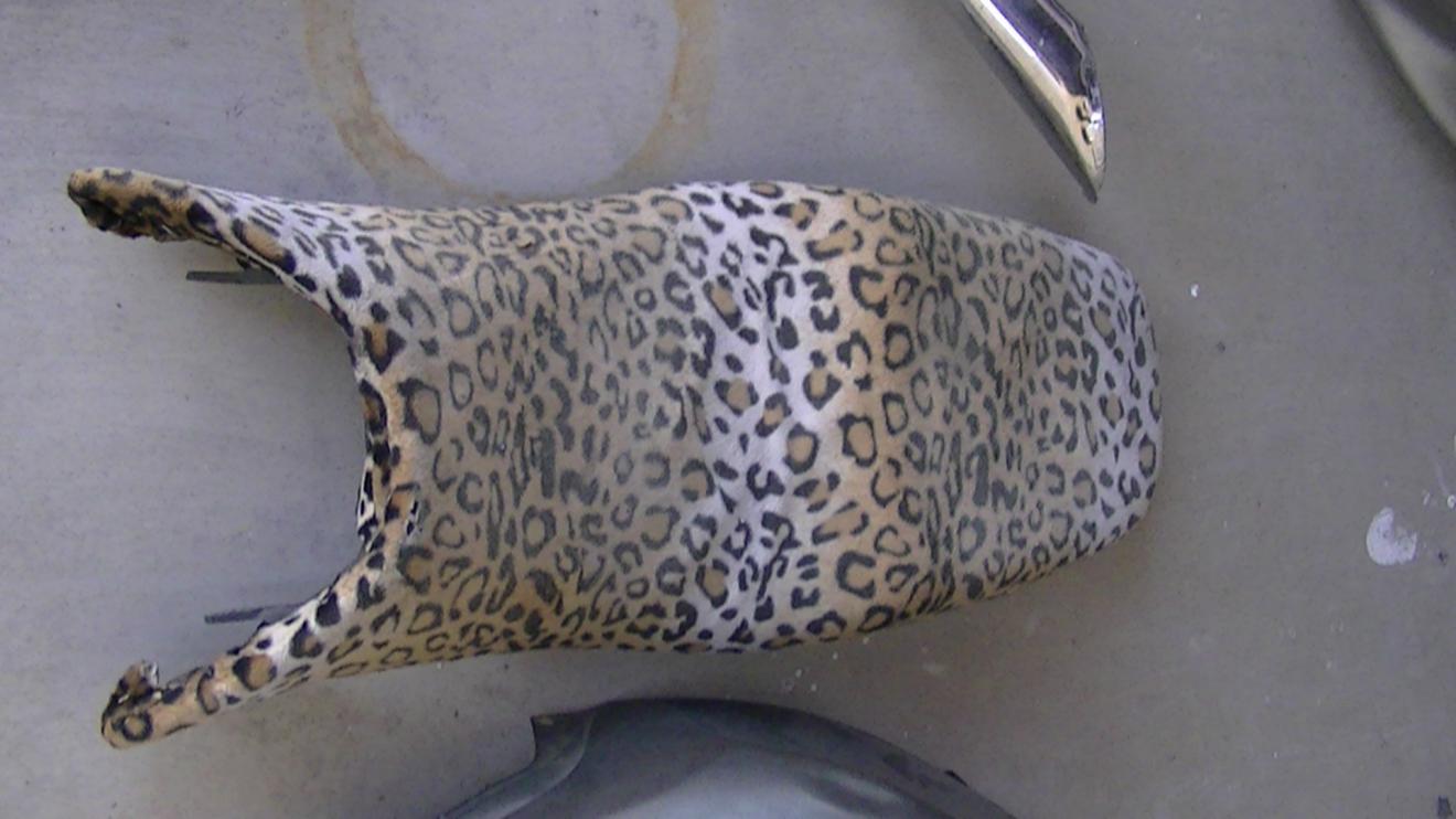

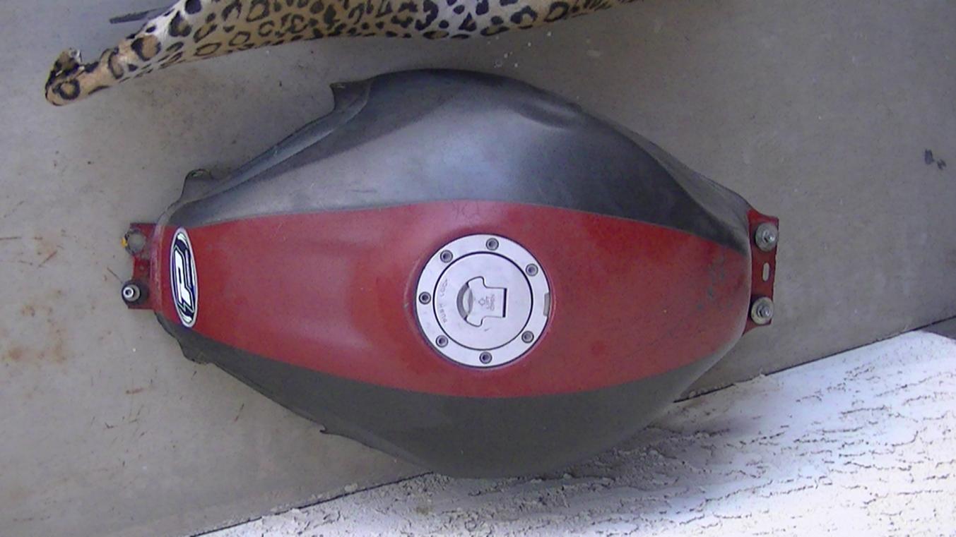

Well she's home! LOTS of work to do. Check out the worlds UGLIEST seat EVER!!! Leopard print? REALLY?!?!?!? WTF? Make it even better, it was a guy that did it..... just..... yeah..... beyond words... LOL

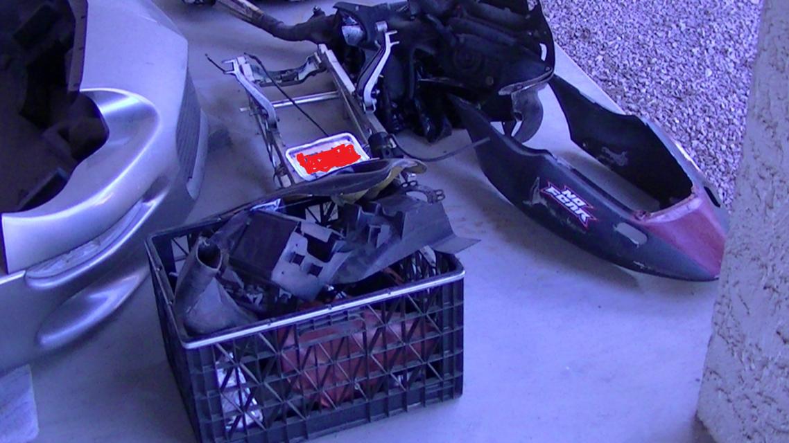

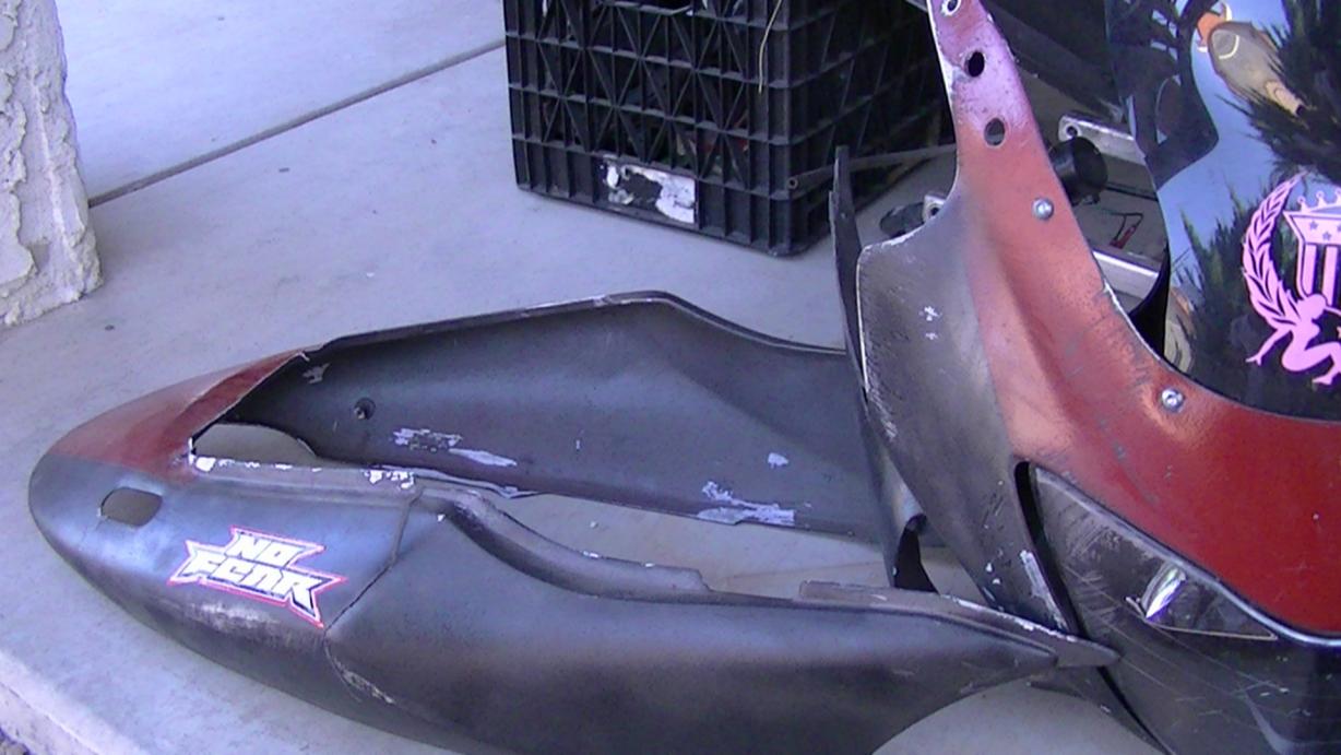

All the plastic is trashed. Beyond the fact that every piece is cracked in at least one place, it looks like the guy rattle canned them without any prep work because the paint is all crinkling/pealing/bubbled/etc.

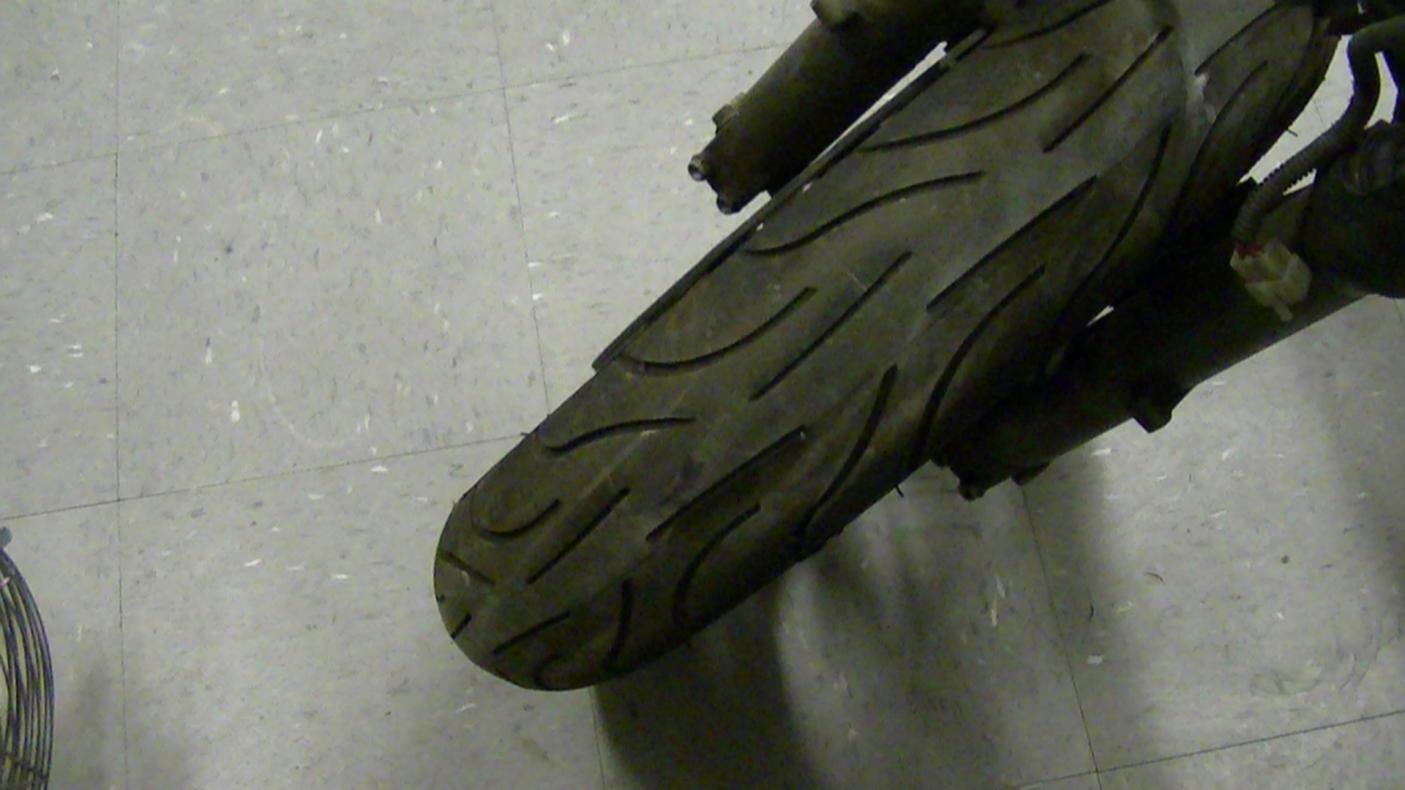

Upshot, the tires are basically brand new (still even have the molding nubs on them)! Score!

Awesome looking bike for a rebuild!! There is a great thread here about painting in the how to section. I think you def need to check it out haha. The plastics can be repaired. I repaired mine with plasti fix. Its a great product. My f4 was dropped in the driveway by the previous owner. With time and attention you can fix plastics for little cost and at least have them primed and ready for paint. That way it wont cost you to have a body guy do the prep work.
Thanks, I'll certainly check that out, though I'm thinking I'll probably upgrade to F4i plastics on the front and do a GSXR tail when it comes time to do the body work. I do agree though about priming it myself.
