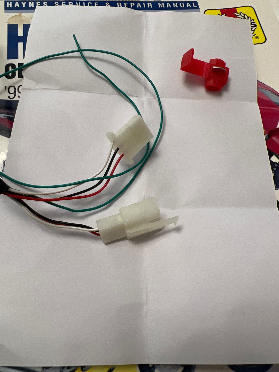

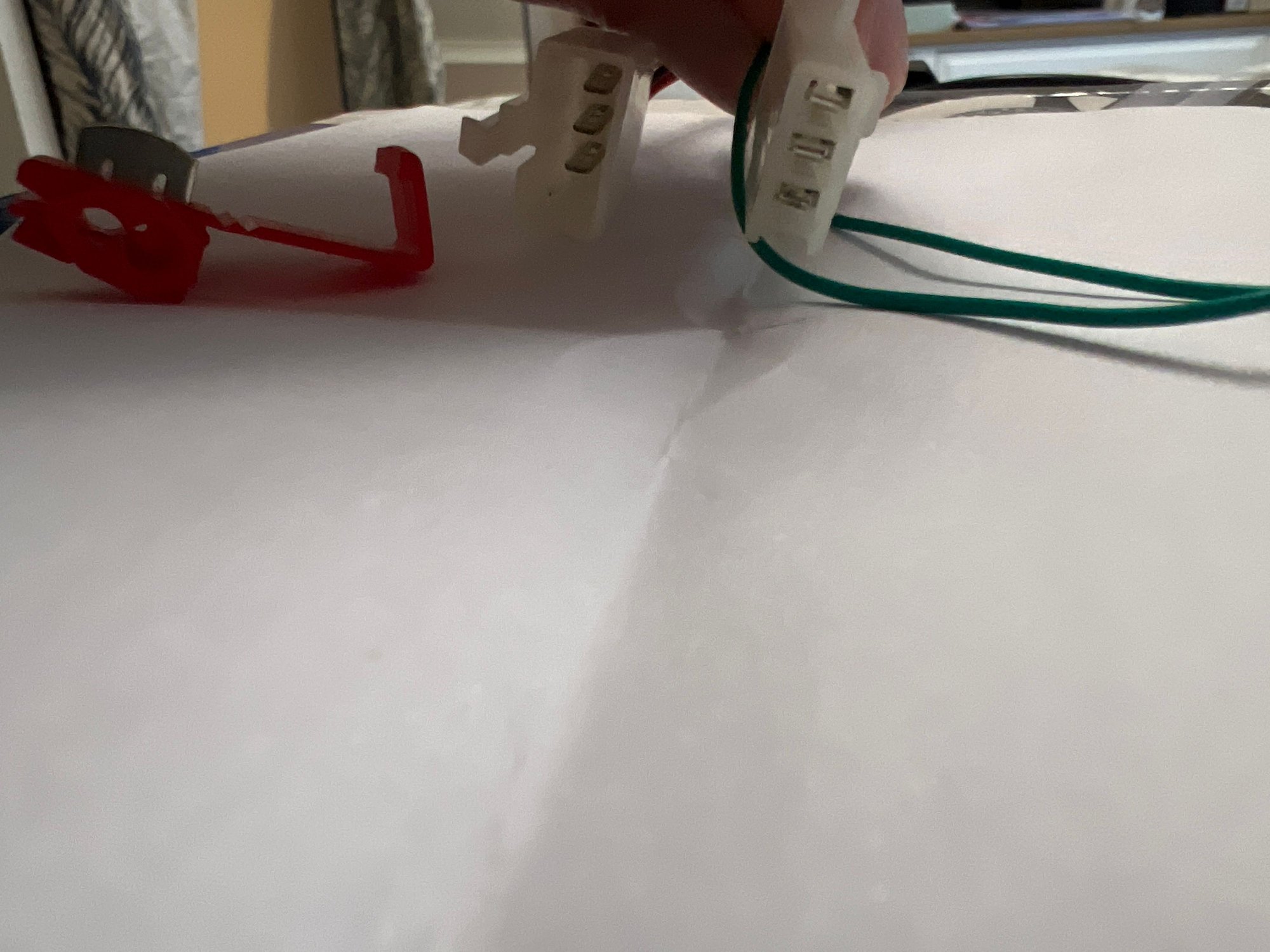

Hi all,
bought one of those eBay gear indicators.
it mentions to locate the “red 4-pole male diagnostic connector (DLC) near the ECU box”
would anyone like to help me in locating this!?
images attached are of the instructions and of the connections provided.
TIA

I don't believe there is such a thing on the F4. these have very "dumb" electrical systems and don't have what most people would define as a computer.

Yeah, no ECU or DLC connector on F4. That unit is for F4i or later models with EFI.
Make sure you get standalone gear-indicator. F4 doesn’t have ECU that communicates with gear-indicator. So you want to get unit with 2 separate up & down switches that detects movement of shifter. Anything that needs to connect to ECU DLC port won’t work.
