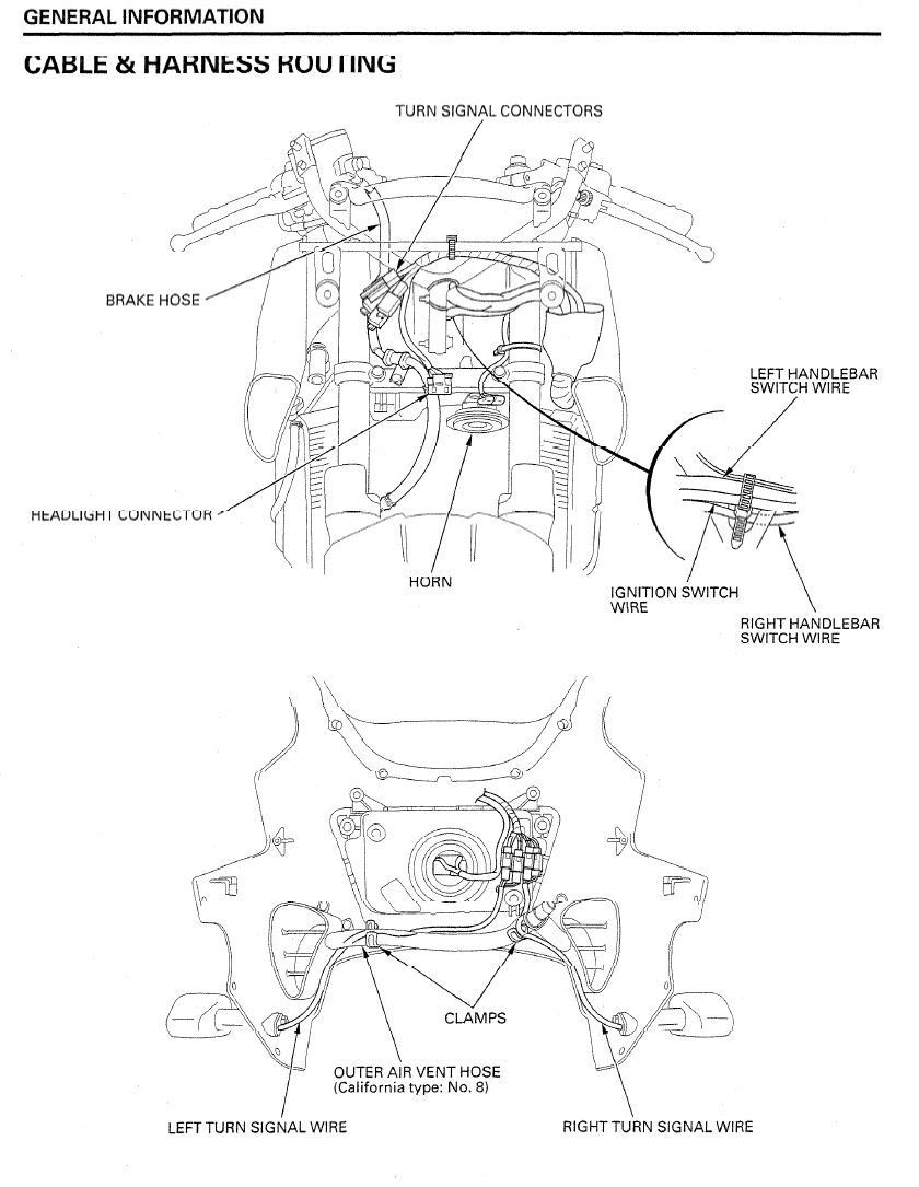

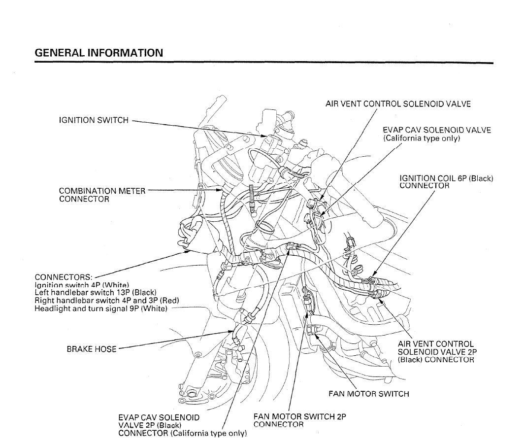

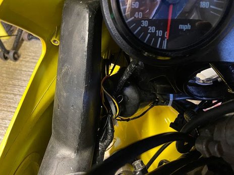

Hi there, does any have a picture or diagram of where the front loom should be routed round the front of the bike?
Mine is a bit messy and im not sure it is quite right.
I have the main block of connectors surrounded by a thick rubber grommet type cover on the left near the ram air plastic pipe. It appears to be getting in the way of the steering slightly when on full lock right.
pictures attached of what I mean but hopefully someone can shed some light on it for me,
thanks
excuse the mess but this is what needs tidying up!!

Originally Posted by Connella08
thanks very much that’s helpful, and shows indeed I have it wrong
