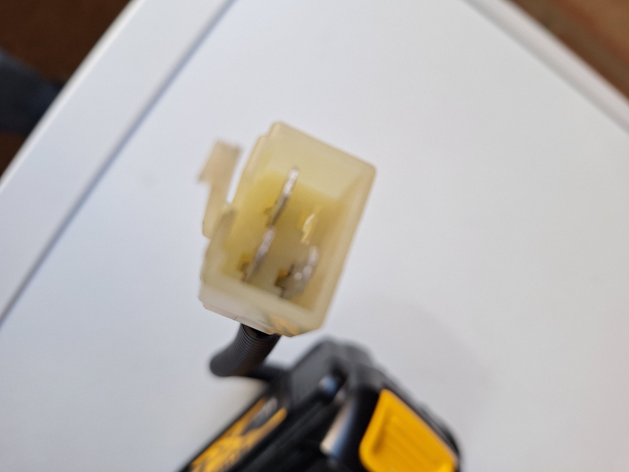

Default 3 wire connector
This is the old connector.
Old Oct 25, 2023 | 05:59 AM
Richard Shelley's Avatar
Joined: Oct 2023
Posts: 15

Thanks a million for your reply. My new switch is the one in the top picture ie the one with it's connector showing. Do you happen to know how that switch should function in the ON position ie which wires does it connect to which ? Mine certainly connects red wire to black wire but seemingly nothing else.
I need it to connect the red wire (+ve) to the black wire (ignition) AND the black/white wire (fan).
As said in my post if necessary I will modify the switch loom by splicing the black/white wire to the black in the loom if I have to. I'm OK with that except that I have a concern over the short piece of wire then carrying ignition AND fan current. It may be OK but just need to check.
