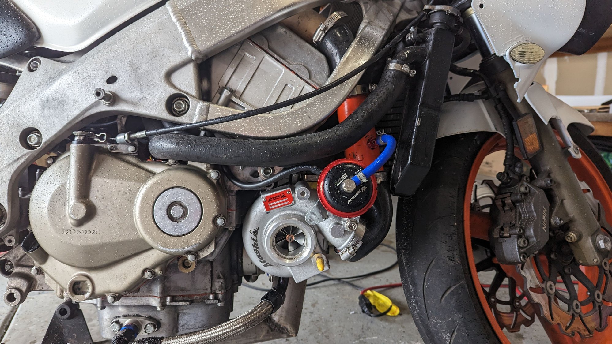

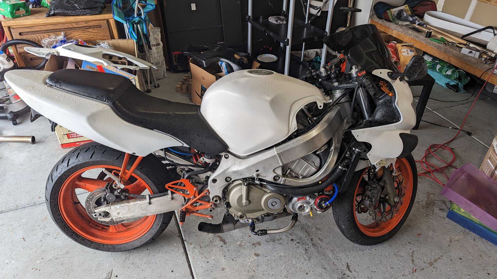

TURBO?!?
Don't see many of those. Please post some photos of your install. Fascinating!
Old Jan 9, 2023 | 01:24 PM
Lin's Avatar
Lin
Joined: Oct 2021
Posts: 35
From: Utah
Thank you for replying, was afraid I needed to clean them. It's just very hard to take it apart with how the intake is setup. I'll probably get it cleaned today. I'm currently running about 5 psi of boost but was originally running 10 psi. And as requested, here are some photos.

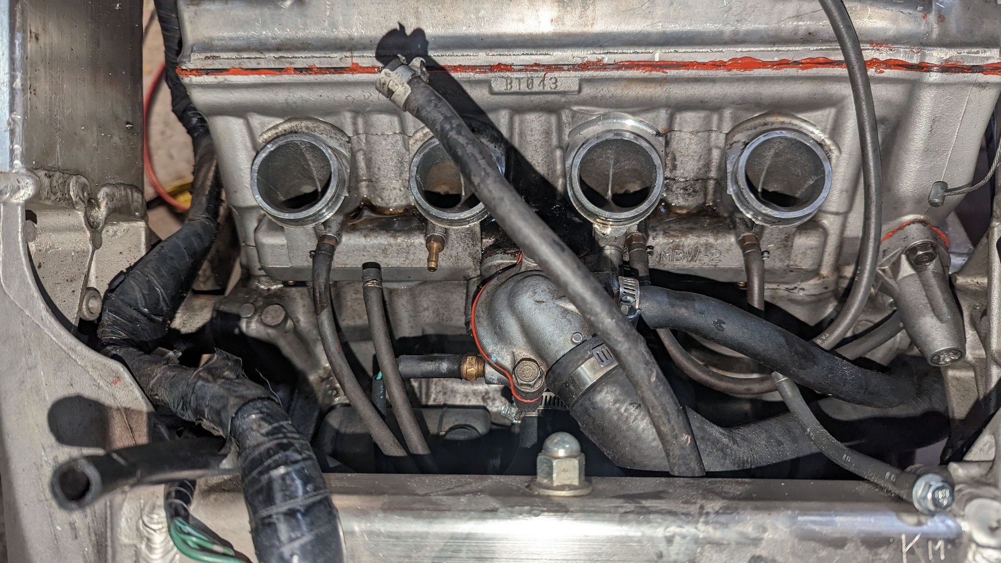

Think I found the primary cause. In the picture below you can see all around the intake is wet, it's fuel. I think the needles aren't sealing and it's forcing extra fuel into the bike and around the carbs. I'm rebuilding them in a little while so I'll make sure to take pictures of the condition of the carbs.
Old Jan 9, 2023 | 04:26 PM
dannoxyz's Avatar
Posts: 1,988
Likes: 439
From: Mesa, AZ
Needles don't seal. It's gap between needles and main-jet that feeds fuel into carb-venturi and into engine.
That liquid petrol is on outside of carbs! None of that spill will ever get into engine, so it won't affect fueling in any way.
Leak in fuel-rail perhaps? Did you replace fuel-rail O-rings?
Could also be float-bowl seals.

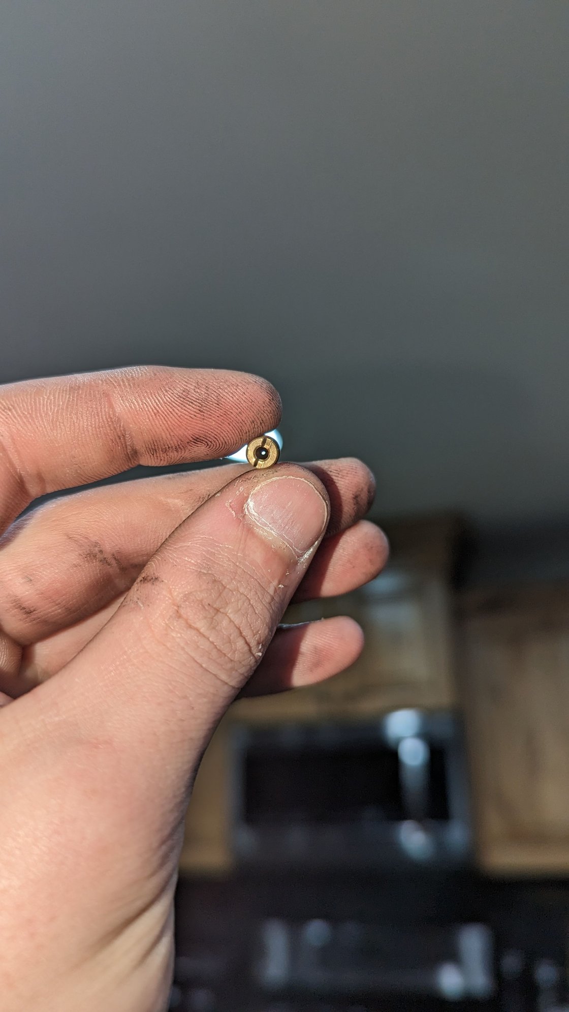

Thanks for the reply, I meant the float needles not the jet needle, my bad lol. And actually I was right, one of them was bad. Here's a good one next to the bad one.

The insides of the carbs are way better than I expected, and the jets are perfectly clear, I did clean them anyway Incase your wondering. what's weird is that I put that bad float needle back in and it working just fine. maybe the seats had some varnish on them that came off while disassembling everything. Or one of the bowl seals was bad and that's what was leaking fuel everywhere. Guess I'll find out when everything is back together. And I plan on syncing the carbs as soon as there on.
