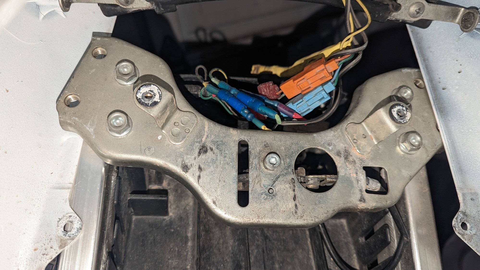

Good news! The coils got the bike running perfect, and I mean like new. But with my luck, that didn't last long. The fuel pump cut-out relay went out and right after I had left to go get gas. Luckily I didn't make it far so I just walked it back. Instead of just ordering the $12 Relay, I decided to just bypass it.
It seems to work ok but only time will tell.
And I have a question about some mounting holes.
Anyone know what these bolt holes are for? There are 4 of them just beside the mount for the rear fairing.
Old Mar 13, 2023 | 08:52 AM
  #23
For EU spec models as well as other markets, there is a rear grab handrail and those are the mounting holes for it. The US market doesn't have that part.
