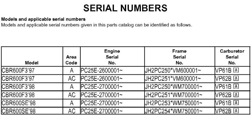

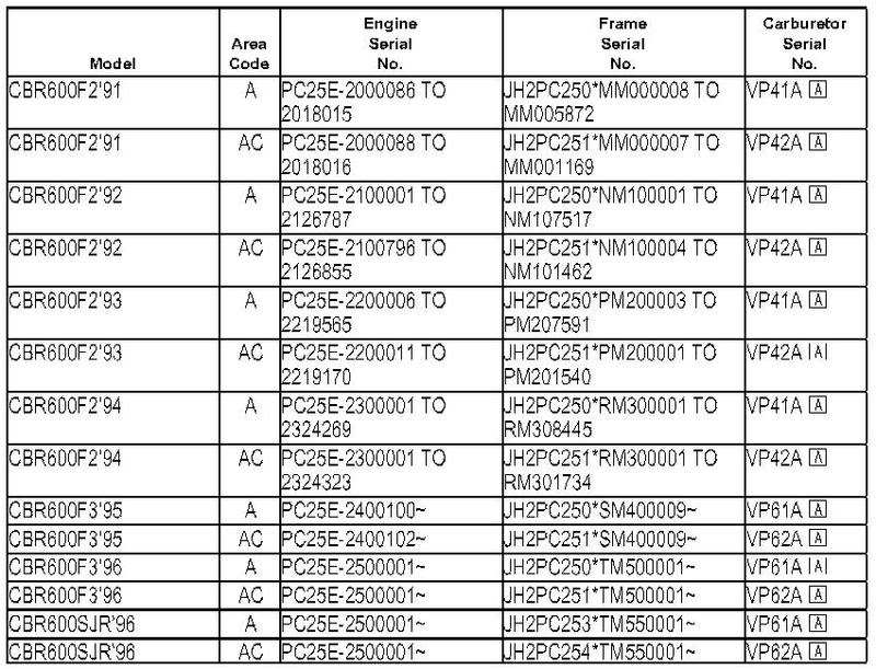

Old Jun 12, 2013 | 09:59 PM
You can check the numbers on the carburetors against this list to determine what year they're off of. Then you'll know what you're dealing with.
A = 49 State
AC = California
A = 49 State
AC = California
thank you but that wont be of any use im in the UK and they are off a uk bike
