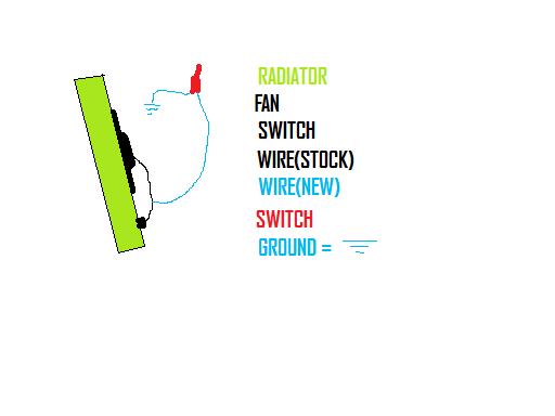

i need some pics of how to do this on a 98 f3 as it heats up while sitting. the fan does turn on but not till its about 3/4 ways up

what i do is leave the fan switch connected (plug with a wire on your rad.) but tap that wire (which just grounds the fan circuit when hot) and run it to a switch then a ground so now YOU can turn it on OR the switch can whichever happens first. then if you aren't paying attention it'll still do it automatically.
