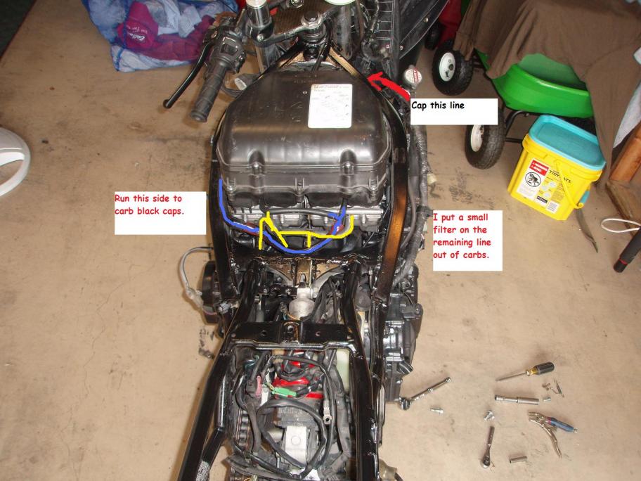

I have my air solenoid bypassed on my 95...what i did was took the left line comming from direct air duct and connected it to the small fitting ontop of the carbs. See the picture
I capped the right side port from the air duct with a think it was a 3/4 black rubber cap.
Blue lines are air induction lines yellow disregard they are fuel.
There is one open like 5/8 hose out of center of carb rack just above the throttle cables. I just put a small filter on it.
Ive put 3k miles on this setup with no problems.
