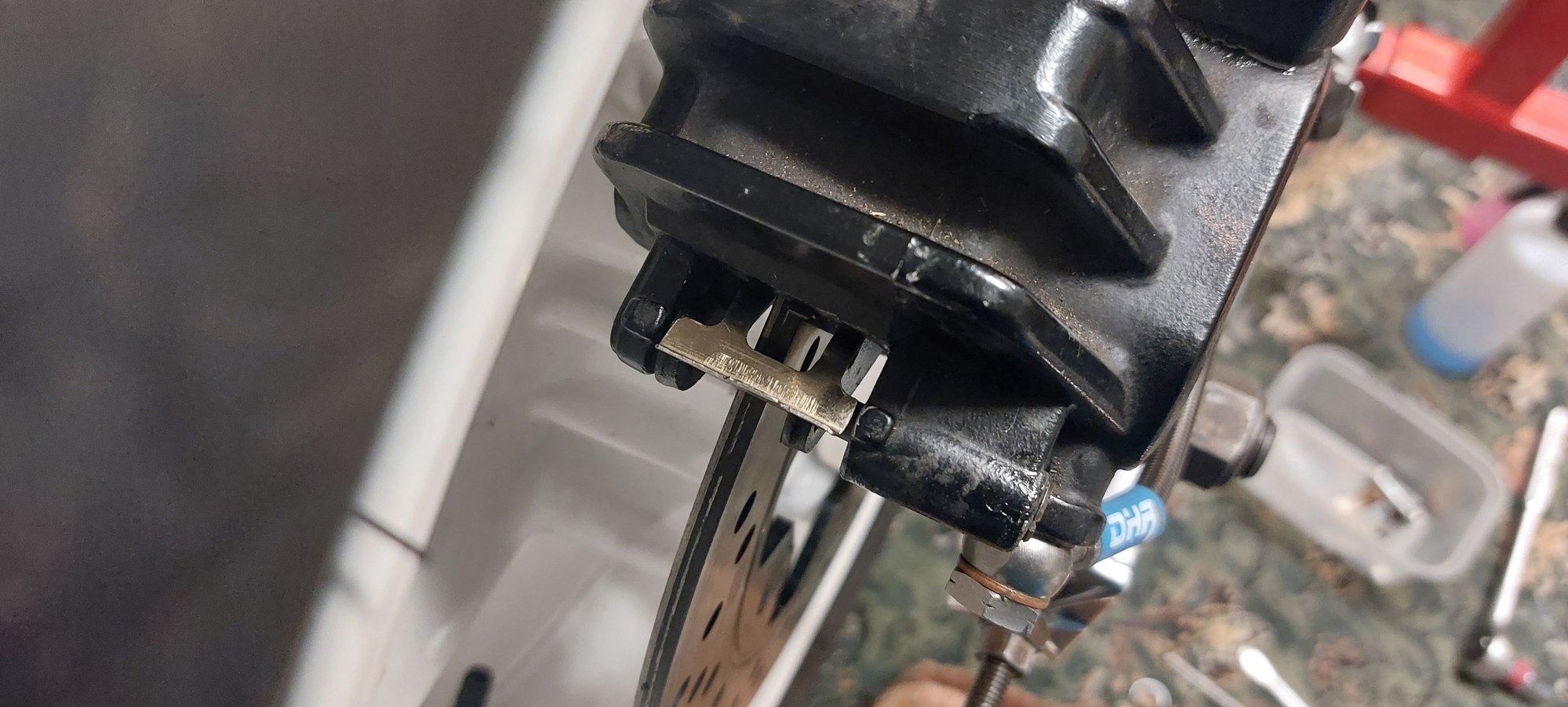

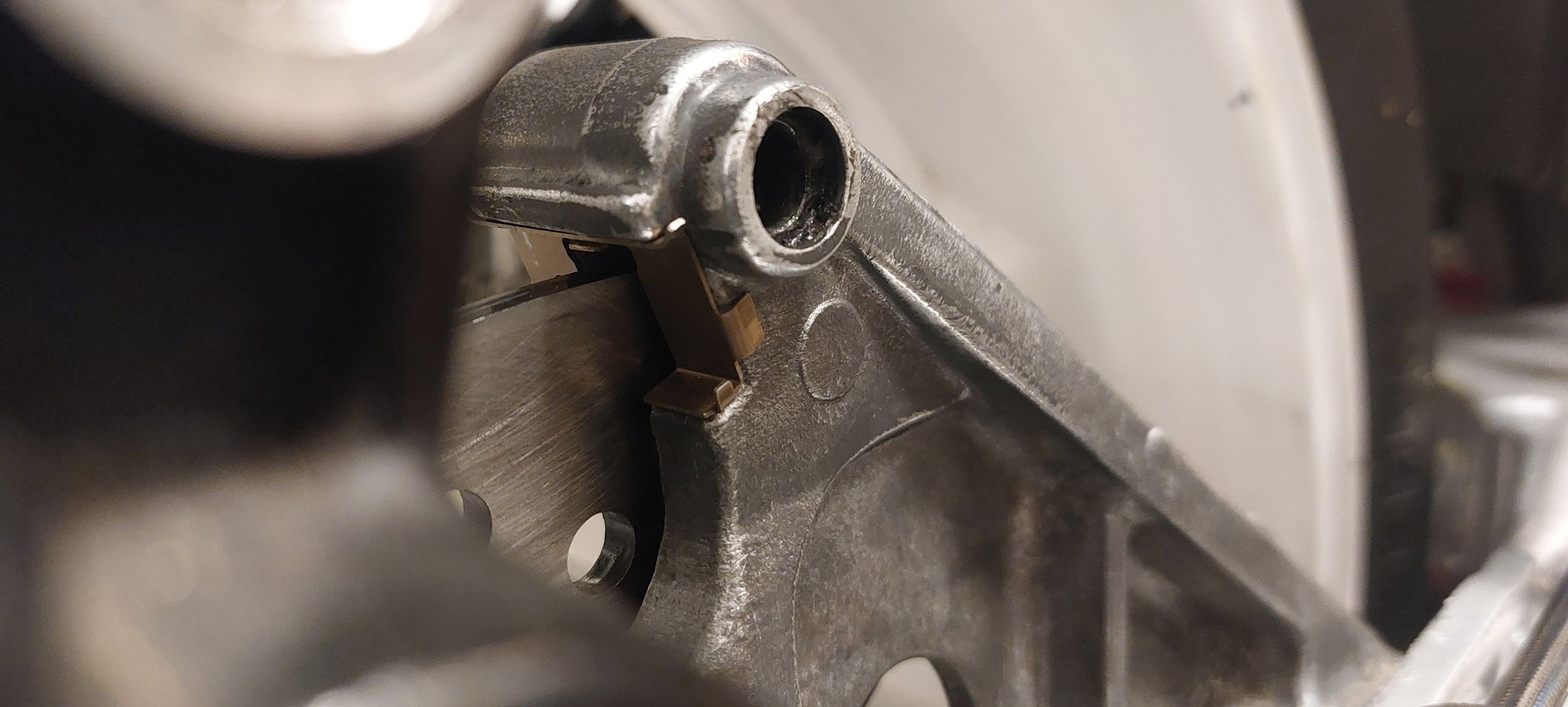

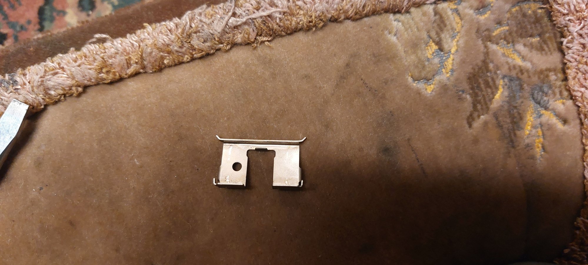

I know this is an old thread, but it is a useful one.
I have rebuilt my CBR1000's swingarm etc, and I got the caliper off to clean the bracket. Two items fell out, a spring and an anti rattle shim. You know how things bug you till they are resolved, I'm typing this at midnight (UK), having just fitted these little herberts.
Anyway, I found out how to replace the spring but no mention of the shim.
I fits into the caliper bracket and the rear of the pads slot into it.
I hope this is a useful addition to this thread for those of us with escaping springs etc.
D.D.
The spring slots in over the pads, with the tab to the rear.
The anti rattle shim.
The shim slots in here.
